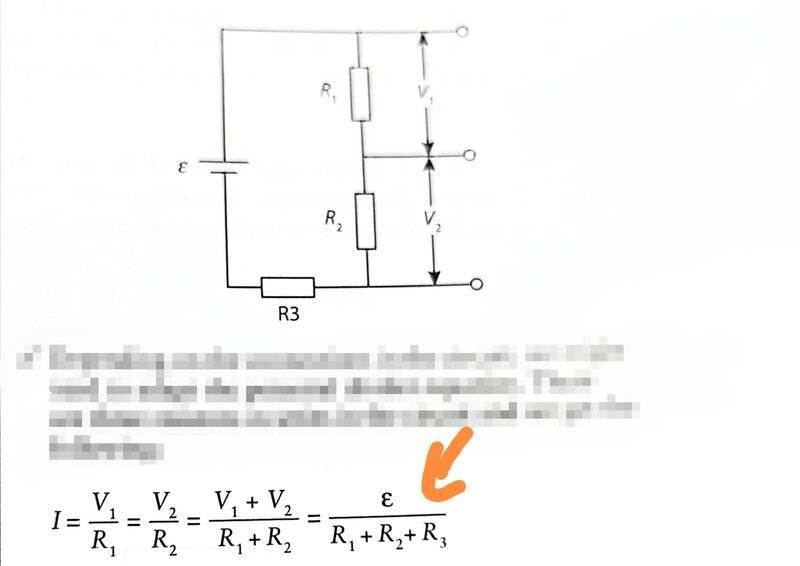

A query about this electrical circuit symbol
The epsilon symbol (ε) represents ElectroMotive Force (emf), which is often used to label voltage sources like batteries. There is a distinction between terminal potential difference (V) and emf (ε), particularly when considering internal resistance in voltage sources. When current flows, the terminal voltage (V) is less than the emf (ε) due to internal resistance, but for an ideal voltage source with zero internal resistance, they are equal. The correct notation for emf is actually the script E (ℰ), which some refer to as a 'curly E.' Understanding these differences is crucial for accurately analyzing electrical circuits.

I'm not sure what this symbol means
V1 = R1 / R1+R2+R3 x "inverted 3"

The epsilon symbol (##\epsilon##) stands for "emf" or ElectroMotive Force. I think it's a bit of a technicality to name voltage sources like batteries with ##\epsilon## while potential difference generated across other components are labeled as Voltage (V).
I know I'm being pedantic but can I add:
1) It is ##\mathscr E## not an epsilon (##\epsilon##). The symbol is a 'script E'. My school physics teacher used to call it a 'curly E'. (To get the symbol with Latex, use \mathscr E.)
2) There is an important difference between the voltage (more correctly terminal pd), V, of a voltage-source and the source's emf ##\mathscr E##.
If the voltage-source has some internal resistance, then when a current flows V is smaller than ##\mathscr E##. But for an ideal voltage-source (zero internal resistance) V and ##\mathscr E## are the same value. Most simple circuit problems assume an ideal voltage-source; in that case you don't need to worry about the difference.
