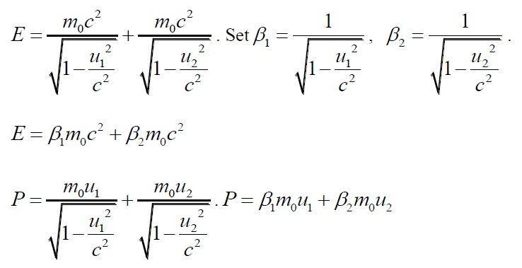

  • #54
I'm sorry. I hope Dale has not left because of anger.
I do not know how to issue formulas in the forum. So I want to use character to explain directly.
But now it seems that words can not explain this problem.
I'll just use a picture. Due to the limitation of the size of the file in the forum, it may not be clear enough.
For these two particles, the static mass of a single particle is m0.
In K, at time t1, the velocity of the two particles is different, one is u1, another is u2. The system's invariant mass is greater than 2m0.

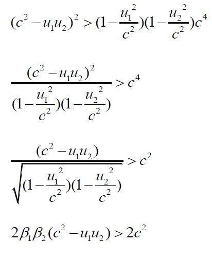

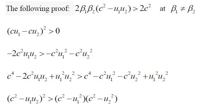

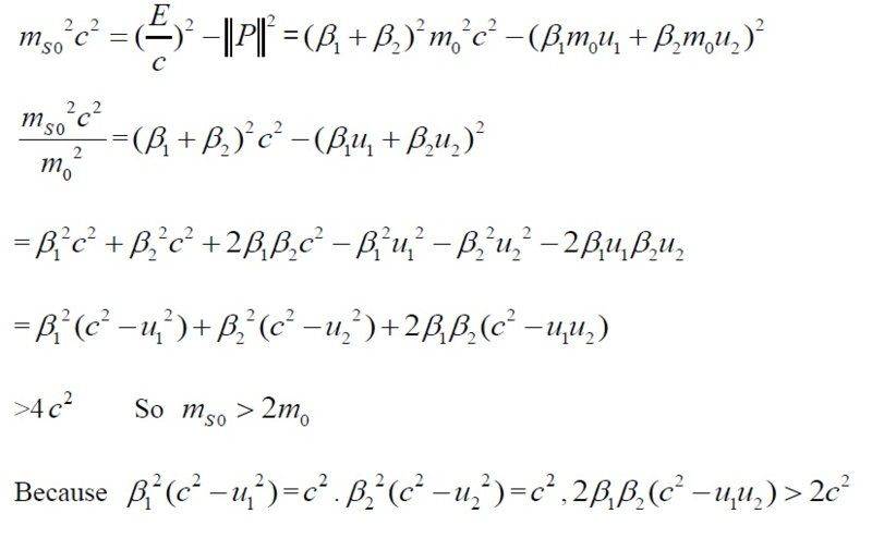

  • #57
Set ##β_1=\frac 1 {\sqrt {1 - \frac {u_1^2} {c^2}}}## ##β_2=\frac 1 {\sqrt {1 - \frac {u_2^2} {c^2}}}##
##E=\frac {{m_0} {c^2}}{\sqrt {1 - \frac {u_1^2} {c^2}}}+\frac {{m_0} {c^2}}{\sqrt {1 - \frac {u_2^2} {c^2}}}##
##E=β_1 {m_0} {c^2} +β_2 {m_0} {c^2}##
##P=β_1 {m_0} { u_1} +β_2 {m_0} { u_2}##
##{m_{i0}^2}{c^2}=(\frac E {c})^2-{\left\| p \right\|}^2##
##=(β_1+β_2)^2{m_0^2}{c^2}-(β_1 m_0 u_1 +β_2 m_0 u_2) ^2##
##\frac {m_{i0}^2c^2} {m_0^2}= (β_1+β_2)^2{c^2}-(β_1 u_1 +β_2 u_2) ^2##
##={β_1}^2c^2+{β_2}^2c^2+2β_1β_2c^2-{β_1}^2{u_1}^2-{β_2}^2{u_2}^2-2β_1β_2 u_1 u_2##
##={β_1}^2(c^2-{u_1}^2)+{β_2}^2(c^2-{u_2}^2)+2{β_1}{β_2}(c^2-{u_1}{u_2})##
##>4 c^2 ## , So, ##m_{i0}>2 m_0##
Because ##{β_1}^2(c^2-{u_1}^2)= c^2##. ##{β_2}^2(c^2-{u_2}^2)= c^2##. ##2{β_1}{β_2}(c^2-{u_1}{u_2})>2 c^2##The following proof: ##2{β_1}{β_2}(c^2-{u_1}{u_2})>2 c^2## at ##{β_1}≠{β_2}##
## (c {u_1}- c {u_2})^2>0##
## -2c^2 {u_1} {u_2}> -c^2 {u_1}^2 - c^2{u_2}^2##
## c^4-2c^2 {u_1} {u_2}+{u_1}^2{u_2}^2> c^4- c^2 {u_1}^2 - c^2{u_2}^2+{u_1}^2{u_2}^2##
## (c^2-{u_1}{u_2})^2> (c^2-{u_1}^2) (c^2-{u_2}^2)##
## (c^2-{u_1}{u_2})^2> (1-\frac {{u_1}^2} {c^2} )(1-\frac {{u_2}^2} {c^2}) c^4##
## \frac {(c^2-{u_1}{u_2})^2} {(1-\frac {{u_1}^2} {c^2} )(1-\frac {{u_2}^2} {c^2})}> c^4##
## \frac {(c^2-{u_1}{u_2})} {\sqrt{{(1-\frac {{u_1}^2} {c^2} )(1-\frac {{u_2}^2} {c^2})}}}> c^2##
## 2{β_1}{β_2} {(c^2-{u_1}{u_2})}> 2 c^2##
  • #58
Correct.
Incorrect.
What your calculation shows is that the energy of the system composed of the two particles, in K, is greater when the two particles are moving. But if the particles are moving, energy divided by ##c^2## is not equal to invariant mass. The particles also have nonzero momentum in K, and you have to take that into account in calculating the invariant mass.
Now go look up the correct formula for invariant mass, including both energy and momentum, and do a correct calculation of the invariant mass of the system composed of the two particles. You will see that it is unchanged.
(I am assuming that the two particles in question are being accelerated in a straight line in a Born rigid manner, so that the distance between them, in either of their instantaneous rest frames, is constant. As far as I can tell, that is the case you are calculating, but you have not been very clear about that.)
