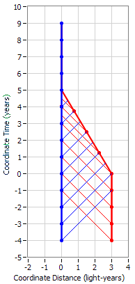

stevendaryl said:
Okay, but I think what people want most from a "coordinate system of the traveling twin" is to be able to say: When the traveling twin is X years old, how old is the stay-at-home twin? I'm not sure if the narrow world tube coordinate system that you describe would answer that question.
Most people may want an answer to the question of how old the home twin is for any age of the traveling twin but they should be told it's a multiple-choice problem where the last choice is "all of the above".
Likes PAllen
  • #65
I'm not sure there is an answer to this question.
Let's talk about a specific case where the issue arises. Suppose we have a classic twin paradox set up, with traveling twin, accelerating at a constant 1g. Said twin asks "what time is it on Earth now" when when he's one light hear away from Earth, at the point where the Earth is at or past the accelerating twin's Rindler horizion, such that light signals emitted from the Earth will no longer be able to catch up with the accelerating twin, assuming he keeps accelerating at the same rate.
The most careful answer is to point out the constraints on the size of an accelerated frame, and discuss how simultaneity is relativeI think, though I suspect in many cases people want and expect an answer to the issue of simultaneity as stevendaryl points out. However, it i s reasonably likely that the people expecting/demanding an answer don't fully accept the fact that simultaneity is relative, part of their expectation of an answer is a carry over from the concepts of absolute time where simultaneity was universal rather than relative.
I don't have a better answer at this point, I think a lot of popularized answers in relativity have come about because it's easier than trying to explain to people that there is no more absolute simultaneity in SR. After a while of trying to explain that simultaneity is relative, I can see why people don't want to go through the hassle, especially when the people asking their questions are asking something that seems unrelated without realizing that the relativity of simultaneity even enters into a complete answer to their seemingly unrelated question.
