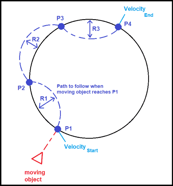

I would really appreciate some help with a challenge I have. It is illustrated in the figure below:
Scenario: The moving object moves with linear velocity until it reaches P1. When it reaches P1, I need to create the motion of the blue dashed path. Whilst the object follows the blue dashed path, it needs to uniformly accelerate from Velocity(start) to Velocity(end).
The following pieces of information are known:
  • Velocity (start), e.g. 5 m/s
  • Velocity (end), e.g. 10 m/s
  • The locations of the four points P1 - P4
  • The location of the centre of the circle
Can anyone please advise how I should go about calculating this path and how to perform the uniform acceleration? Clearly the linear acceleration equations do not apply here since it is not a straight line, but I am not sure how to make use of the angular accelerations since the object is not following a circular orbit.

You will need to know the value of the radius of the circle, plus R1, R2 and R3.
You will have centripetal and tangential accelerations along that blue path.

I do know the radius since I know the centre of the circle and the four points.
Knowing R1,R2,R3 is a bit more difficult. Since I am using Bezier curves, I am placing an additional control point for each arc some distance away to approximate the shape of the arcs and therefore R1,R2,R3. So these values are not actually known until the motion takes place. Perhaps using Bezier curves is a bad way of doing it? Ideally I would be able define the R1-3 values and then create the motion for those values specifically, but I know of no way to achieve this.
Do you know if there is a better way for creating the motion? And even if this was not an issue, which equations would adequately describe the accelerations you mention.
The problem is not specific about the points of inflection, but at least P2 and P3 should not have the abrupt changes of direction shown in the picture.
If so, those points should be contained in a straight line that connects the centers of two contiguos semicircles.

You are absolutely right regarding the abrubtness of the changes in direction. The diagram is simply an approximate sketch and poor drawing on my part. In reality, the arcs should smoothly connect for a more natural curvature. I will update the OP.
That being said, do you have any comments on how to tackle the challenge?
I would resolve it geometrically.
Perhaps other members could offer a mathematical approach pretty soon.

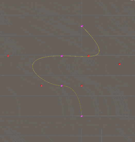

@robphy As mentioned the bezier curves do allow a pretty good approximation. Here is a demo of my code running a bezier curve. It joins two discrete arcs to create a fairly smooth curving motion (it is not the same path as the OP but it illustrates the point of being able to create a curved motion):
Essentially I compute a position using the formula:
pos =
oneMinusT * oneMinusT * p0 +
2f * oneMinusT * t * p1 +
t * t * p2;
where t is the elapsed time. However as mentioned, the speed is constant and I do not know how to get the yellow dot to accelerate between a "start" and "end" velocity as it performs the motion. Perhaps I need to find the second derivative of the above formula? I am simply not sure how I can create the ramp in a controlled manner. The other problem with the Bezier method is I cannot define the R1-3 values, since Bezier curves rely on additional control points to approximate the path. Ideally if I could create a precise path with my own R1-3 values that would be ideal.

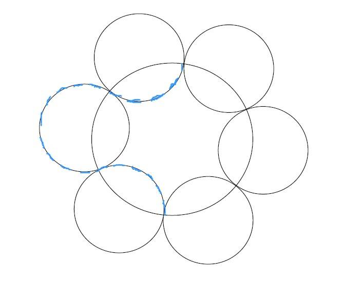

As I understand your problem, you are looking to solve for motion with a constraint like ##|\dot{\vec{r}}|=bt+c##.
You could take a polar parametrization like ##r(t)=R_0(1+d\sin{\theta(t)})##, substitute it into the polar form of the constraint, ##|\dot{\vec{r}}|=\sqrt{\dot{r}(t)^2+r^2\dot{\theta}(t)^2}=bt+c##, and then, probably numerically, integrate for ##\theta(t)##.

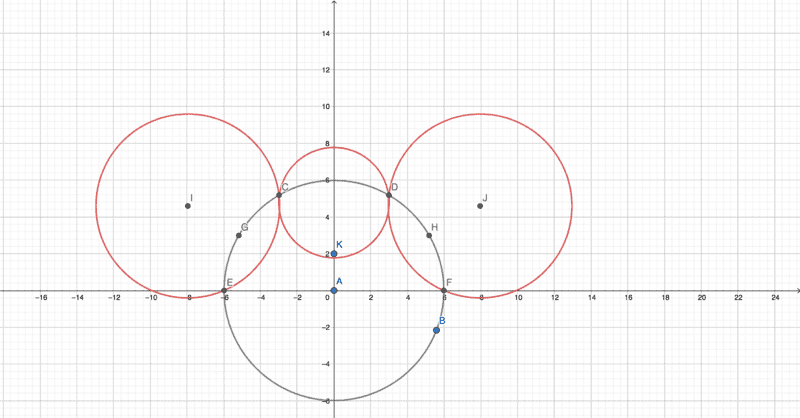

Sorry to come in so late BUT.,
It looks like the incoming path is meeting the circle (at P1) along a normal (perpendicular to the tangent).
Is that true, and is that also true for P2 , P3 and P4?
If that is true, the centre of each blue arc is at the intersection of tangents drawn at P1 & P2, P2 & P3 and P3 & P4.Is P4 intended to be opposite P1 (on opposite ends of a diametre)?
If so, are P1, P2, P3 and P4 intended to be 1/3 of a circle away from each other?
If all that is true, I think the length of the dotted blue line is 8.(sqrt3).pi,R/9 where R is the Radius of the black circle. (4 times the first dotted blue arc).
Is the dotted blue line in my graphic the sort of path you were after?
Peter
Likes Cato11 and Lnewqban

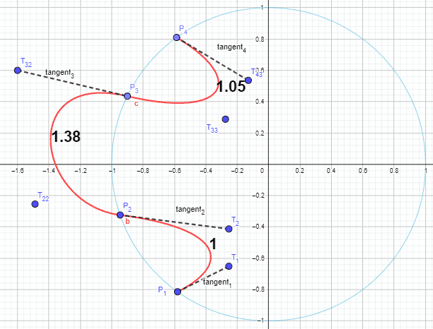

@jbriggs444 (#20) Thank you for the extra clarification!
@robphy (#21) I think what you mention is the real key here. I need to reparametrize the path with a new T between 0 and 1. I have found quite a lot of discussion on arc length parametrization. I spent about 6 hours on it yesterday without much progress (argh!). I will keep working on it and hopefully post the results back here soon.
@PeterO Yes you are correct about the P1 and P4 being 180 degrees apart. It looks like your path is the Dubins Path method someone else mentioned here earlier. The curvature of this path is not exactly what I was after, as the bulge of the centre circle is beyond what I was looking for. I think the bezier curve method works best, if I can only figure out how to properly reparametrize the spline (three separate arc curves joined together). Thank you for the suggestion though.

My suggestion to parametrize from 0 to 1 is just so we know the beginning and the end, independent of how you design your curve. Presumably the parametrization is just the arc-length divided by the total arc-length.
I think the biggest problem is to first design your curve, as you say, as a spline of multiple arcs.
If I recall correctly, you want the arcs to join with common tangents at the boundary circle.
I presume you want some movable intersection points on the boundary.
Maybe you want to specify the tangent lines of the trajectory at those boundary points.
Then determine the curve from those constraints.

My apologies, I thought I made that clear. What I am trying to accomplish is to get a moving object to uniformly accelerate from a define start speed to a defined end speed, as it travels through a curved path. The curved path is a spline comprised of multiple arcs. There can be two arcs as shown in my post #14, or three as shown in the OP. The shape of the curve shouldn't really matter as it should be changeable.
Based on people's feedback in this thread, my understanding is that I need to do a few things:
1. Find the total path length of the curve
2. Parametrize the path with a 'T' value between 0 and 1
3. Adjust my scaling of 'T' to accelerate from one speed to another
It seems that this is more of a math problem vs a physics one so I am struggling myself to fully understand where to go with this. My apologies if this reply doesn't help, I am in something of a quandary!
What is still not clear (at least to me) is if the object is physically constrained to move along this curved path or are you independently controlling the objects motion to force the acceleration to be uniform and how? Also, if we had a clue as to why you are doing this it may help as well. Is this just an academic exercise or is there a point to it?

The length of the middle trajectory or bulge of the center circle must always be greater than the other two.
Less severe difference could be achieved with reduced angle of incidence of the intial straight trajectory (less than perpendicular, or by reducing the length of the middle arc of the big circle respect to the other two.
It just occurred to me that in order to reduce the visual difference some and to avoid the many radii of spline lines, you could replace those three circles with three ellipses.

The #24 graph assumes a path of equal radii circle arcs, but it's (almost) as easy to use differently-sized circles for the satellites.
What's interesting (to me, anyways) is that all the angles incident to the main circumference will be the same, no matter what differing radii the satellite arcs are.
In that graph, they're identical. [edit : and it appears I've lost track of the path a bit]
