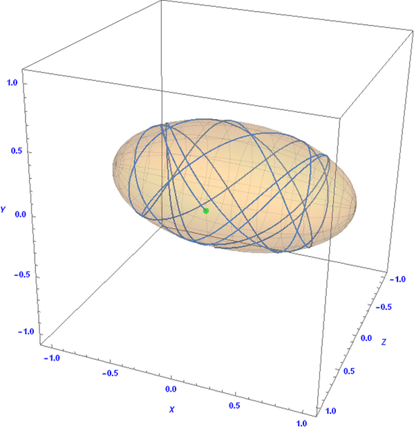

The picture below shows the particle's trajectory for the case where the ellipsoid is not rotating. In this case, ##H = E##. The particle moves at constant speed along a geodesic of the ellipsoid. Even when ##\omega = 0##, the trajectories can be complicated. The green dot is the starting point and the initial velocity was arbitrarily chosen.

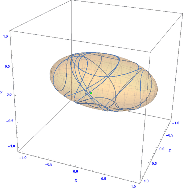

The picture below is for the same initial conditions but for an arbitrarily chosen ##\omega \neq 0##.
Now the trajectory over the ellipsoid can be very complicated due to the centrifugal and coriolis forces in the rotating frame of the ellipsoid.

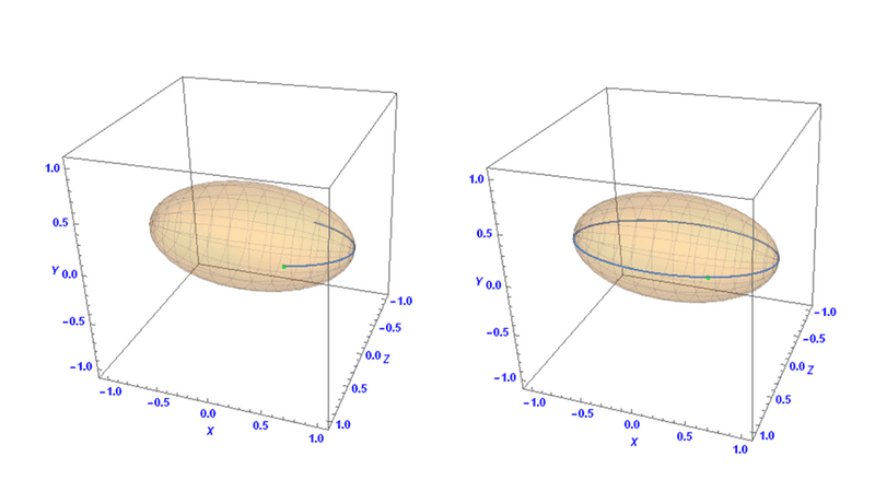

We can get oscillations or orbits for the rotating ellipsoid if the trajectory lies in the x-z plane.
On the left, the particle oscillates on the blue arc in the x-z plane. On the right, the particle orbits around the ellipse in the x-z plane. Since ##\phi## is fixed at 0 here, ##\theta## is the only variable. So we would have only one action variable ##J_{\theta}##.
