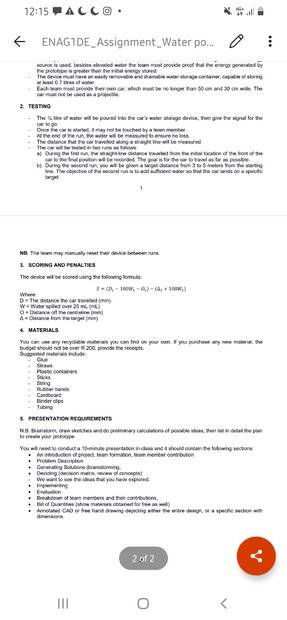

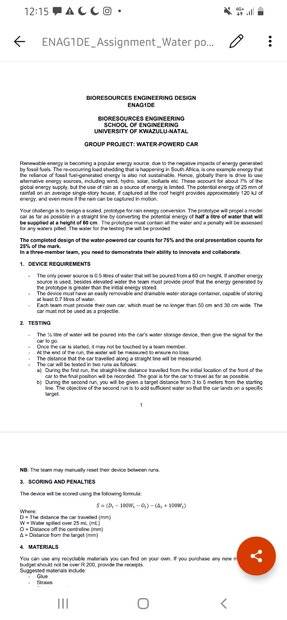

If another energy source is used, I must be able to prove that the produced energy is greater than the initial energy, I've enclosed the rules if you would please kindly assist.
