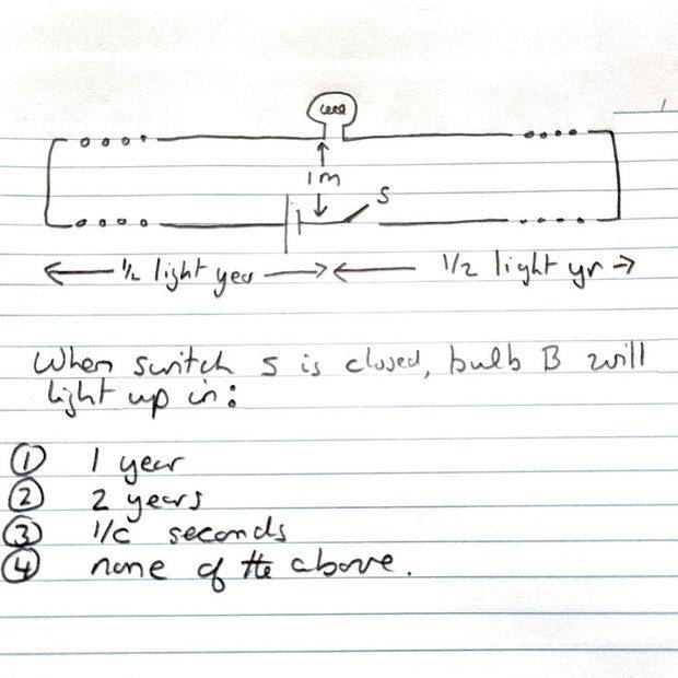

Veritasium on YouTube https://www.youtube.com/c/veritasium/community has posted this problem, inviting viewers to say what would happen:
Is the following answer correct?
In series with the battery, switch and lamp are two transmission lines. At ##t = 0^+##, we will have twice the characteristic impedance ##2Z_0## of the line in series with the lamp. Since the wire spacing is 1 meter, ##2Z_0## would be quite large, which will limit the current and won't let the lamp glow. Once the voltage steps make one round trip (simultaneously) though the left and right lines, the series impedance will drop to zero and the lamp will light up.
But if we replace the lamp with a neon lamp or an LED, and use a high enough voltage, then the lamp would light up instantly because then the ##2Z_0## would be less than the lamp resistance.

The question is a mares nest, made up of unspecified parameters;
1. The voltage of the battery. It may be 1 V or 1 kV.
2. The impedance of the transmission line. (What diameter are the wires?) 1 m = short circuit.
3. The DC resistance of the very long transmission lines.
4. The cold resistance of bulb B.
5. What is actually meant by “will light up”, a momentary flash, or a continuous dull red glow.
You can get any answer you want by setting different parameters.

The question smokes out two principles.
  1. One of the base assumptions of CA (Circuit Analysis) is "The time scales of interest in CA are much larger than the end-to-end propagation delay of electromagnetic waves in the conductors.
    Source https://www.physicsforums.com/insights/circuit-analysis-assumptions/"
    Typical EM propagation speeds in wires is of the order 0.7-0.8 c.
  2. Forget electricity and circuits. Basic relativity tells us that we can't propagate information faster than light. So you can't have a switch that triggers a bulb 0.5 light years away with less than 0.5 years delay. Drawing circuitry in this question is a diversion. The mechanism is irrelevant. Signals can't travel faster than light.

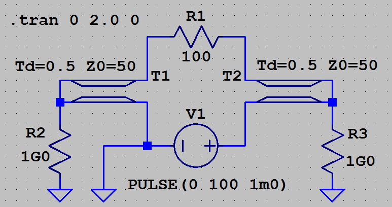

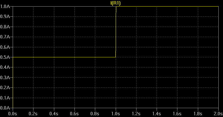

Here is a simulation of lines matched to the global load. For time, treat the seconds as years.
The two 1G0 resistors are needed to satisfy the initial DC bias of the transmission line model.
When V1 first rises to 100 V, the 100 ohm globe receives half current because the circuit resistance is 50+100+50=200 ohms. When the reflection of the short circuit finally gets back, the resistance falls to 0+100+0=100 ohms, so the full current flows from then on.
Lowering the line impedance will brighten the globe initially, but reflections will go on forever.

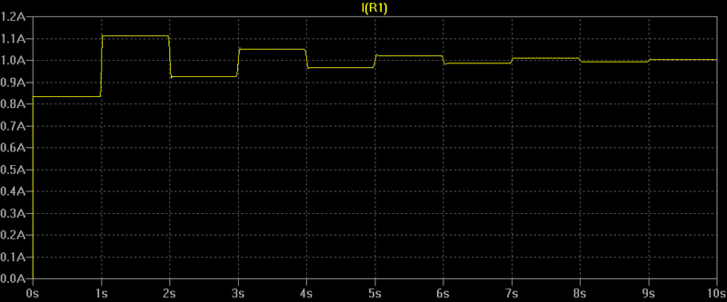

Here it is with 10 ohm transmission lines and immediate visible light.
Will a filament bulb survive the second year with more than 10% over-voltage ?
