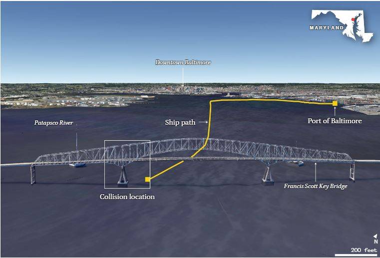

My assumption with my post was that they appeared to be lined up properly such that the rudder would have been pointed directly aft. It seems like a pretty bad design to have to twist the rudder to one side in order to continue in a straight direction (minus any outside effects like current). The fuel impacts alone are mind-boggling.
I'm also not clear on the rudder dynamics when power is lost. Assuming that it is using hydraulics, it would just remain in position when power is lost.
What I can see from this image, and previous "marinetraffic" AIS data, is that there seem to be very few GPS datapoints after the ship made the turn into the straight. Unfortunately I can't download the historical data as there is a paywall...

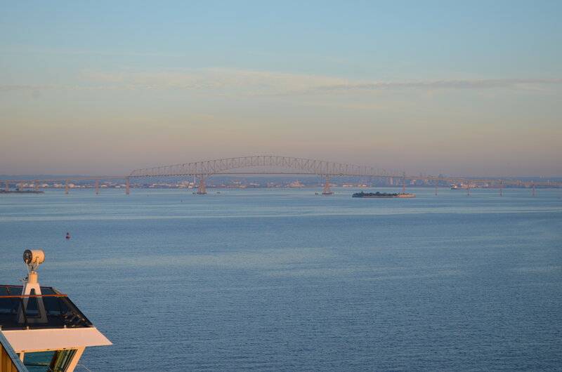

The space between water and the highest point on a vessel is called 'air draught' A nice term which should tell you your headroom. According to Google, the tidal range in Baltimore harbour is less than 2 feet which is small compared with many places (many metres). Hitting overhead structures is not altogether rare; that's something that a Pilot should know all about.

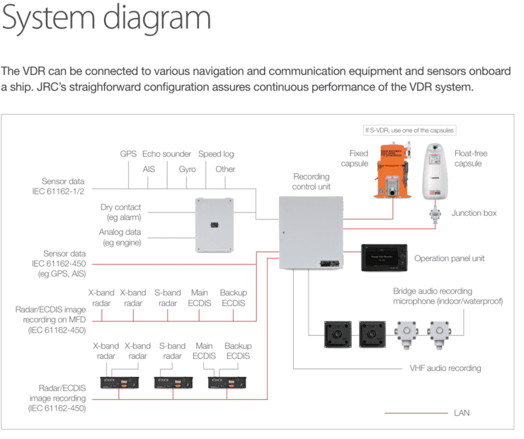

I've seen in a couple places that the Vessel Data Recorder (VDR) seemed to shut down during each of the power loss windows. That seems really strange to me that the VDR and all sensors are not battery backed up to enable recording during a ship power outage. Does anybody have any knowledge about VDR systems on ships?
1:24 a.m. -- The livestream camera shows the cargo ship's lights suddenly going off and then coming back on.
1:24:59 a.m. -- Numerous audible alarms go off on the bridge of the container ship. The VDR temporarily goes off.
https://abcnews.go.com/US/timeline-...llapse-shows-moments-cargo/story?id=108540377
