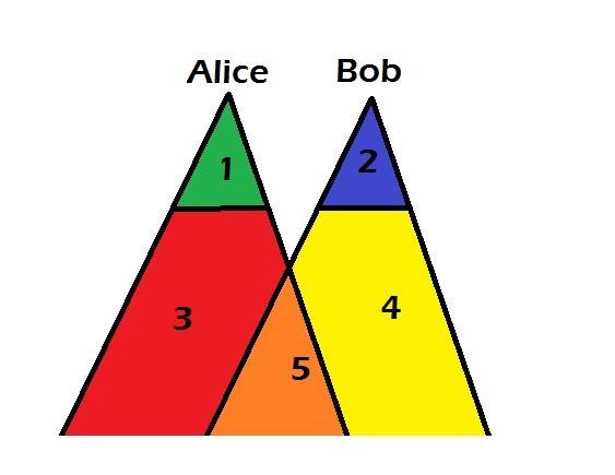

It's just a fact about local realistic theories, which the most complete physical theories prior to quantum mechanics were.
The idea is that in a locally realistic theory, what happens in a small region of spacetime depends only on conditions in that region, not on conditions in far-off regions. What that means is that if there is a correlation between measurements in distant regions, it has to be because there was already a correlation in the conditions in the neighborhoods of those regions.
In any field other than quantum mechanics, this is just considered obviously true. Suppose that you find out that for a pair of twins, if one is a good badminton player, then the odds are that the other will also be a good badminton player. If you're a scientist, you would not be content with such a correlation as a final answer. You wouldn't conclude: "Well, I guess there's a law of physics stating that twins have correlated badminton abilities". Instead, you would look for a mechanism for the correlation. Maybe the correlation is genetic: There is some gene, or combination of genes, that influences a person's badminton ability. Maybe the correlation is environmental: There is some type of nurturing that is likely to produce good badminton players, and twins tend to share this experience. Or maybe it's a combination of nurturing and environment.
The expectation is that we don't really understand the correlation until we have a complete set of causal influences on badminton playing ability. Typically, we might never get to the bottom of such a question, because humans and badminton are too complicated to understand in complete detail. But in principle, we believe that it should be possible to come up with some enumeration of contributing factors to badminton ability:
  • [itex]F_1[/itex] = some gene combination
  • [itex]F_2[/itex] = some in-vitro conditions prior to birth
  • [itex]F_3[/itex] = some physical conditions after birth (weather, terrain, air and water quality in the region where the twins grew up)
  • [itex]F_4[/itex] = parental child-rearing practices affecting the twins
  • [itex]F_5[/itex] = presence of siblings with particular qualities
  • [itex]F_6[/itex] = influence of teachers and coaches
  • etc.
Even though such a complete list is unlikely to ever be found, scientists typically believe that there could be such a list. Such a list would completely explain the correlation between the twins' badminton abilities. We would know that the list is complete if we could predict someone's badminton abilities based on knowledge of their variables [itex]F_1, F_2, ...[/itex]. If, on the other hand, twins had correlated badminton abilities even after taking into account [itex]F_1, F_2, ...[/itex], then we would take that to mean that we were missing a causal influence.
  • etc.
