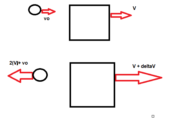

LCSphysicist said:
Homework Statement:: A trouble with quantity of motion, impulse and force.
Relevant Equations:: All below
I thought i could apply a conservation of momentum in this case,
View attachment 264183View attachment 264182
Apparently, this is not right, so i don't know what to do now.
How do you get the ##2V+v_0##? Does your equation make sense when ##V=v_0##?
You must need to use the elasticity somewhere.
Likes LCSphysicist
I wonder i could change to the reference of the block, but this is leading me to some contradictions. I don't know why, see example:
A ball is going with 50m/s, and the block 30m/s.
Now the ball has 20m/s in block frame, and go back with -20m/s
But in the block frame, the ball has
+20 + 30 = +50
-20 + 30 = +10, what is wrong, because the ball need to back off.
Considering the mass of the block very large with respect to the ball.
Maybe i just can use this when the two blocks are approximating?
