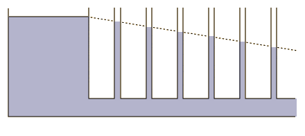

I would appreciate some help with some basic stuff. Consider this picture, from HyperPhysics.
Edit: The image looks fine when I preview. You should be able to see it if you click "Reply".
This is about water, not air. They're saying that the pressure is dropping through the horizontal pipe, as indicated by the picture, and that the pressure at the exit, further to the right, is equal to the atmospheric pressure.
I seem to have misunderstood something basic, and I'm trying to understand what. This is the source of my confusion:.It seems to me that the velocity can't change through the horizontal pipe, because the same mass of water must pass through each vertical cross section of the pipe every second. That means that ##\frac 1 2 \rho v^2## is the same everywhere in the pipe. So Bernoulli's equation implies that the static pressure is the same everywhere in the pipe. But this contradicts the HyperPhysics claim.

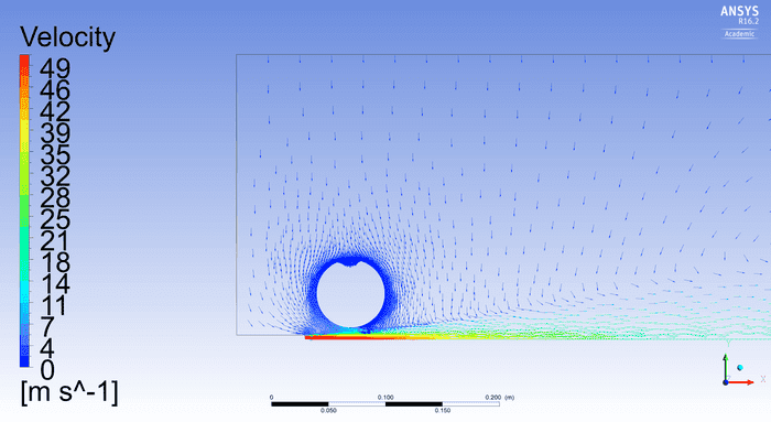

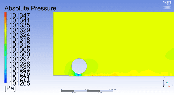

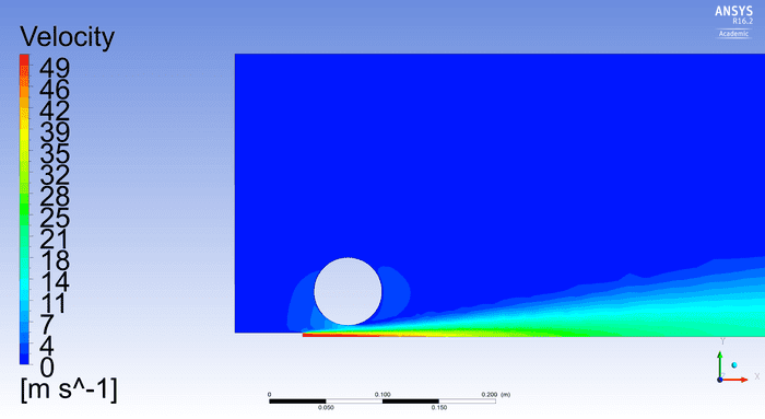

I'm wondering about an angled jet blowing over a convex surface so that a low pressure flow exits near horizontally?
Assuming density does not change, then both volume flow and mass flow remain constant. The pressure energy decreases as the flow proceeds through the pipe due to friction losses converting pressure energy into heat. Bernoulli equation needs to be modified to account for the friction losses.
This too seems to be inconsistent with what that HyperPhysics page is saying. It claims that the water pressure at the exit will be equal to the air pressure outside. That wouldn't always be the case if the pressure drop is caused by friction.
Yes it would: the flow is pressure driven. Friction provides the resistance.
Yes it would. If viscosity is taken into account, you simply need a higher upstream pressure to achieve the same mass flow rate for a given exit pressure.
