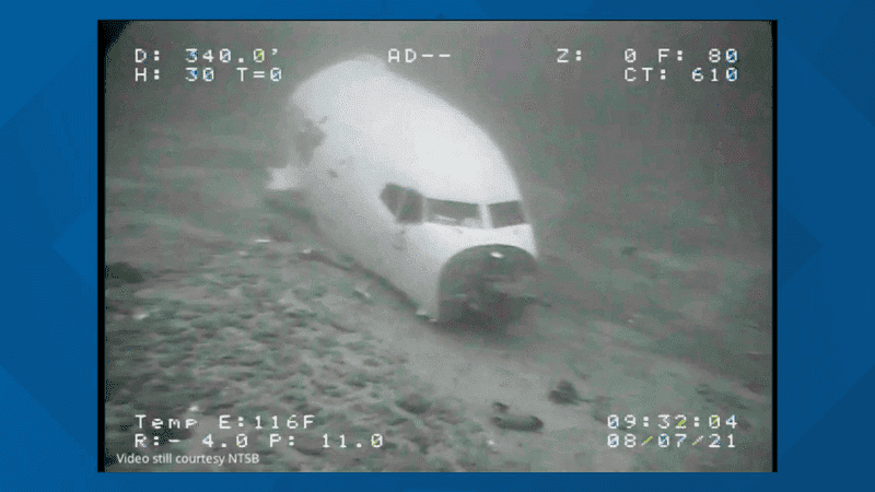

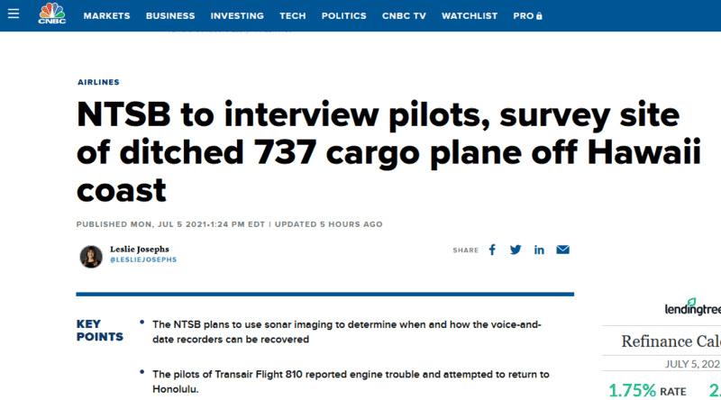

I haven't been keeping up -- did they locate the plane on the bottom and have they recovered the data recording boxes?
I did a quick Google search, and it looks like they are working on the recovery...
The water is quite deep - a few hundred feet. (I know...Pearl Harbor would be a swell place to put a Navy base) It may take some specialized gear.
