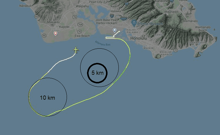

250 kts * 2 minutes / pi = 5 km diameter using the "standard turn" from Wikipedia.
I drew one 5 km and two 10 km diameter circles on the map (from Bloomberg), there should have been more than enough space to fly in circles. The turn towards the airport matches a 10 km diameter pretty well.
Likes anorlunda and Vanadium 50

I think @mfb posted a pretty good map. Both the takeoff and the turnaround circles are about 6 miles in diameter. It also looks like they are about 6 miles away from what would be in hindsight the best position, which is not too far off from the famous 87 seconds.
