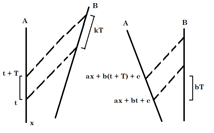

I'm studying Core Principles of Special and General Relativity by Luscombe. In the section on Bondi's ##k##-factor, it says:
Let inertial observers ##A## and ##B## in relative motion carry identical clocks. ##A## sends two flashes of light to ##B##, a time ##T## apart. What time separation does ##B## measure? ... We know that worldlines of free particles are straight in IRFs, and that spacetime coordinates in different IRFs are related by a linear mapping. The time difference measured in B must therefore be proportional to ##T##, call it ##kT##.
I want to clarify if my derivation of the above claim is correct. The image on the left is what's included in the text and referred to by the above paragraph. I made the image on the right to understand what's going on with linear transformation of worldlines.
Let ##E_S## and ##E'_S## be the events corresponding to ##A## sending the two light signals, and let ##E_R## and ##E'_R## be those corresponding to ##B## receiving them. The claim is that if the time separation between ##E_S## and ##E'_S## is ##T## in ##A##'s frame, then the time separation between ##E_R## and ##E'_R## is ##kT## in ##B##'s frame.
Following the reasoning given in the bold line of the above paragraph, suppose I switch from ##A##'s frame to ##B##'s frame. Then the worldline of ##A## will undergo some linear transformation ==> I can assume that the time coordinate of ##E_S## will become ##ax+bt+c## and the time coordinate of ##E'_S## will be ##ax+b(t+T)+c##.
The time separation between ##E_S## and ##E'_S## will then be ##bT## in ##B##'s frame. Finally, from this we can get the time separation between ##E_R## and ##E'_R## in ##B## frame as being proportional to ##bT##, say ##r(bT)##, using simple geometry. The overall effect is that separation b/w ##E_R## and ##E'_R## in ##B##'s frame is proportional to that between ##E_S## and ##E'_S## in ##A##'s frame, with ##k=rb##.
Does that seem correct? Or is there a flaw in the derivation?

I'm not familiar with the k-calculus, so I'm not sure what one can assume. I would say that to see the linear relationship you would have to work out kinematically both the time and space coordinates of the receiving events in A's frame, then transform these to B's frame using a general linear formula for coordinate transformations.
I don't believe you can just consider the time coordinates. If you want to work it all out, that is.
In general, unless your book does things differently, using a prime ##'## for coordinates in B's frame would be better and the four events would be ##S_1, S_2, R_1, R_2## in A's frame and ##S'_1, S'_2, R'_1, R'_2## in B's frame. I.e. you have four events with two coordinates in each frame.
PS I suspect the book expects you just to accept that linear + linear = linear without working out all the details. If you do undertake a kinematic analysis, then you'd be better off using ##t_1, t_2 = t_1 + T## for the times of ##S_1, S_2##. And use ##t## as a variable in your kinematic equations.

The postulate is that a straight worldline implies inertial motion, and combine that with the fact that a free particle remains free in any inertial frame of reference. This means that if a particle has a straight worldline in one inertial frame, then it'll continue to have a straight worldline in any other IFR. So you can assume the linear relationship between worldlines.
Your notation is certainly more sensible. As for considering the time coordinates, basically the way to measure time between events in a certain IFR is to record the difference between their time coordinates in that IFR. So I'm guessing that should be sufficient to work out the relationship between the time difference between ##S_1, S_2## and the time difference between ##R'_1, R'_2##?
Considering all of the above, does my method seem to make sense (as I described in the OP)?

I don't know. On balance, I'd say it doesn't prove anything. Rather than the kinematic analysis I suggested above, you could do some plane geometry instead.
The book says: look at the geometry, assume coordinates are related linearly, conclude ##T' = kT##.
You say: change the geometry somewhat, assume coordinates are related linearly, conclude ##T' = kT##.
On the one hand I'd say that sounds reasonable. On the other, if someone asked me to prove it, I'd work out the whole thing properly, either kinematically or geometrically.
Fair enough, but I thought what I said was a geometric argument. As in, the book just provides the diagram on the left, which is essentially a spacetime diagram as drawn by someone in ##A##'s frame. Even using any sort of geometry arguments, if I only use that spacetime diagram, I'll only get quantities as measured in ##A##'s frame.
My reasoning for referring to the spacetime diagram in ##B##'s frame (the one on the right) was so that I can calculate ##T'##, which is a quantity measured in ##B##'s frame.

what I'm saying is:
consider ##T##, which is a quantity measured in ##A## frame, use the linear mapping postulate to relate it to a quantity ##bT## in ##B## frame, and then finally use geometrical argument (this time only confined to the ##B## frame) to relate that to ##T'##. Transitively conclude that ##T'=kT##.
Not looking to stubbornly convince anyone or argue (you probably know much better than I do), but I am looking to make clear my thought process.
Of course, there might still be potential holes in the argument, but that's the best I can do given what the book says. I really dislike taking things at face value and just assuming stuff without working it out.
I'd say that to do it properly, the argument is something like this. Starting in A's frame:
First, without loss of generality, we take A's worldline to be the line ##x = 0##. B's worldine to be the line ##x = vt## (where ##v < 1##). The first sending event to be at ##(t_1, 0)##, the second sending event to be at ##(t_1 + T, 0)##. And, the paths of the light signals to be defined by ##x = t - t_1## and ##x = t - t_1 - T## respectively.
Then, we find the coordinates of the receiving events, which are where these light signals intersect the worldline of B. This involves solving the equations:
##x = vt = t - t_1## and ##x = vt = t - t_1 - T##
If we label these two events as ##3## and ##4##, we get:
##t_3 = \frac{t_1}{1-v}, \ x_3 = \frac{vt_1}{1-v}##
##t_4 = \frac{t_1 + T}{1-v}, \ x_4 = \frac{v(t_1+T)}{1-v}##
Now we can see that ##t_4 = t_3 + aT## and ##x_4 = x_3 + bT##, where ##a = \frac{1}{1-v}## and ##b = \frac{v}{1-v}## are constants.
Finally, we can transform to get the time coordinates in B's frame:
##t'_3 = \alpha t_3 + \beta x_3## and ##t'_4 = \alpha t_4 + \beta x_4##
And, we see that:
##T' = t'_4 - t'_3 = \alpha (t_4 - t_3) + \beta (x_4 - x_3) = \alpha (aT) + \beta (bT) = kT##
For some constant ##k##.
Now that we've done this, we can laugh and see that there was nothing to worry about. The relationship between ##T'## and ##T## had to be linear all along! Just like the book says. :smile:

Many thanks! So essentially you've started with time coordinate difference between ##S_1, S_2##, then used geometry to get the time coordinate difference between ##R_1, R_2## and then finally used linear transformation to get time coordinate difference between ##R'_1, R'_2##. In a nutshell, ##(S_1, S_2) \implies (R_1,R_2)\implies (R'_1,R'_2)##. What I'd described was ##(S_1,S_2)\implies(S'_1,S'_2)\implies(R'_1,R'_2)##.
I'll do the calculations and put them in a subsequent post in this thread. Again, thanks so much.

Yeah, or just ask yourself how any non-linear terms are going to arise when everything is linear?
I see your point. The transformation from the time coordinate difference between ##(S_1, S_2)## to that between ##(R_1,R_2)## turns out to be linear, as you've shown geometrically. The other between-frame transformation is linear too, so it'll be linear in the end regardless of the order.

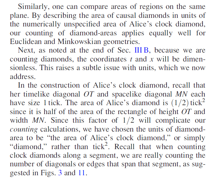

The area of the diamond can be given by the cross-product, independent of metric. (See calculation below.)
Here is an excerpt from the appendix on my paper
"Relativity on rotated graph paper" American Journal of Physics 84, 344 (2016); https://doi.org/10.1119/1.4943251
(where I've specified my definitions)

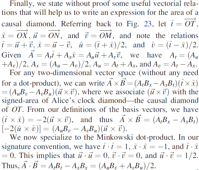

https://dx.doi.org/10.1119/1.4943251 said:
Without proof some useful vectorial relations
that will help us to write an expression for the area of a causal diamond.
(Refer back to the figure.)

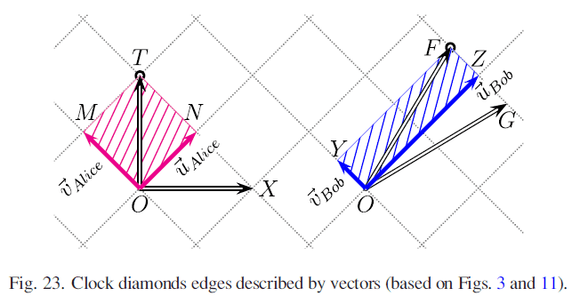

Let [itex] \hat t=\vec{OT} [/itex], [itex] \hat x=\vec{OX} [/itex], [itex] \vec u=\vec{ON} [/itex], [itex] \vec v=\vec{OM} [/itex],
and note the relations
[itex] \hat t=\vec u+\vec v [/itex], [itex] \hat x=\vec u-\vec v [/itex],
[itex] \hat u=(\hat t+\hat x)/2 [/itex], and [itex] \hat v=(\hat t-\hat x)/2 [/itex].
Given [itex] \vec A=A_t \hat t+A_x \hat x=A_u\vec u+A_v\vec v [/itex],
we have [itex] A_t=(A_u+A_v)/2 [/itex], [itex] A_x=(A_u-A_v)/2 [/itex], [itex] A_u=A_t+A_x [/itex], and [itex] A_v=A_t-A_x [/itex].
For any two-dimensional vector space [without any need for a dot-product],
we can write [itex]
\vec A\times \vec B
=(A_tB_x-A_xB_t)(\hat t\times \hat x)
=(A_uB_v-A_vB_u)(\vec u\times \vec v)
[/itex],
where we associate [itex] (\vec u\times \vec v) [/itex] with the signed-area of Alice's clock diamond---the causal diamond of [itex] OT [/itex].
From our definitions of the basis vectors, we have [itex] (\hat t \times \hat x)=-2(\vec u \times\vec v) [/itex].
Thus, [itex]
\vec A\times \vec B
=(A_tB_x-A_xB_t)(-2(\hat u\times \hat v))
[/itex].
We now specialize to the Minkowski dot-product.
In our signature convention,
we have [itex] \hat t\cdot\hat t=1 [/itex], [itex] \hat x\cdot\hat x=-1 [/itex], and [itex] \hat t\cdot\hat x=0 [/itex].
This implies that [itex] \vec u\cdot\vec u=0 [/itex], [itex] \vec v\cdot\vec v=0 [/itex], and [itex] \vec u\cdot\vec v=1/2 [/itex].
Thus, [itex] \vec A\cdot \vec B=A_tB_t-A_xB_x=(A_uB_v+A_vB_u)/2 . [/itex]

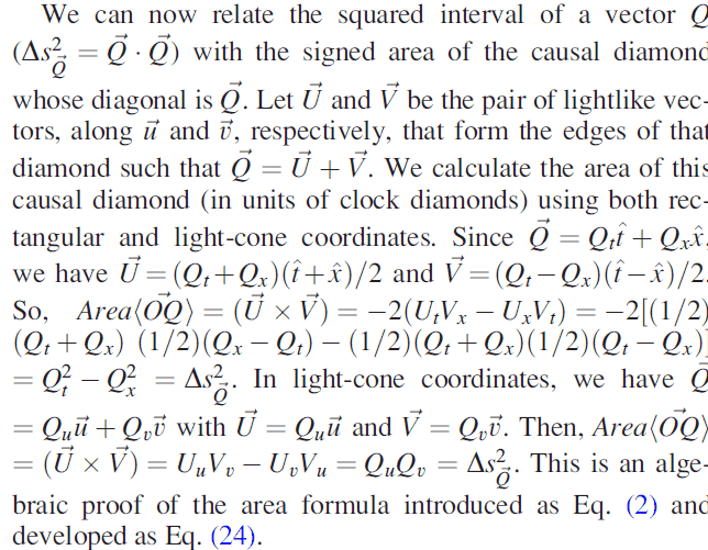

We can now relate the squared interval of a vector [itex] \vec Q [/itex] ([itex] \Delta s^2_{\vec Q}=\vec Q\cdot \vec Q [/itex])
with the signed area of the causal diamond whose diagonal is [itex] \vec Q [/itex].
Let [itex] \vec U [/itex] and [itex] \vec V [/itex] be the pair of lightlike vectors,
along [itex] \vec u [/itex] and [itex] \vec v [/itex] respectively,
that form the edges of that diamond
such that [itex] \vec Q=\vec U+\vec V [/itex].
We calculate the area of this causal diamond (in units of clock diamonds)
using both rectangular and light-cone coordinates.
Since [itex] \vec Q=Q_t\hat t +Q_x\hat x [/itex], we have
[itex] \vec U=(Q_t+Q_x)(\hat t+\hat x)/2 [/itex] and [itex] \vec V=(Q_t-Q_x) (\hat t-\hat x)/2 [/itex].
So,
[itex]\begin{align*}
{\cal A}(\vec{OQ})=( \vec U \times \vec V)
&= -2(U_t V_x - U_x V_t)\\
&=-2\left(
\left(\frac{Q_t+Q_x}{2}\right)\left(-\frac{Q_t-Q_x}{2}\right)
- \left(\frac{Q_t+Q_x}{2}\right)\left(\frac{Q_t-Q_x}{2}\right)
\right)\\
&=Q_t^2-Q_x^2\\
&=\Delta s^2_{\vec Q} \end{align*} [/itex].
In light-cone coordinates,
we have [itex] \vec Q=Q_u\vec u+Q_v\vec v [/itex]
with [itex] \vec U=Q_u\vec u[/itex] and [itex] \vec V=Q_v \vec v . [/itex]
Then, [itex] \begin{align*}{\cal A}(\vec{OQ})=( \vec U \times \vec V)=U_uV_v-U_vV_u
&=(Q_u)(Q_v)-(0)(0)\\
&=Q_uQ_v\\
&=\Delta s^2_{\vec Q}\\
This is an algebraic proof of the area formula.

tom.capizzi said:
"A(OQ→)=(U→×V→)=−2(UtVx−UxVt)=−2((Qt+Qx2)(−Qt−Qx2)−(Qt+Qx2)(Qt−Qx2))=Qt2−Qx2=ΔsQ→2."
The second line was clipped in the post. I see it now after pasting it. There is still a problem, however. Trying to refer to the paper in the link, and it says I don't have access unless I buy it.
Here's a screenshot from that closing section.
