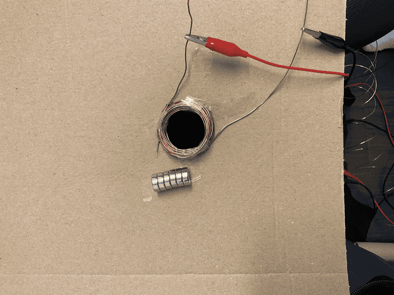

I have been trying to calculate the magnetic flux thought a single loop of wire occurring from a magnet (meaning it has a nonuniform field), so I have the following equation:
Φ=∮BdAcosθ
Now my problem is that I do not know how to calculate the magnetic field strength (B)of that magnet (which has a cylindrical shape) in order to find out its flux. I have not seen a clear answer to this on the internet, although I think that is is possible to use the Biot Savart equation in some form to do this?

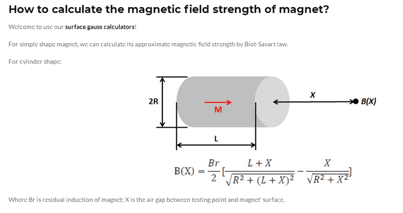

In general, I think it's pretty hard and usually done via simulation (like with COMSOL). However, I did a Google search on your thread title, and came across this link that seems to have some approximations that may give you what you want:
https://www.magnet-sdm.com/2017/08/01/magnetic-field-strength-permanent-magnet/

Thank you. Indeed this is the only thing I have come across earlier today. This distance X representing the air gap between the testing points, how is it determined? And how could I find it?? I am a bit confused about this part, maybe you can give me an explanation there.
Φ=∮BdAcosθ

bob012345 said:
Also, there is this Wolfram demonstration project of the field of a cylindrical bar magnet.
https://demonstrations.wolfram.com/MagneticFieldOfACylindricalBarMagnet/
I just read this post. Here they gave the two equations attached below. Which one is for what? I see they are pretty similar but have some slight differences to them. In theory, can I just substitute values into this equation and obtain the value for B that I am looking for??

@Einstein44 To answer your post 25, you only need to look at ## B_z ## for your geometry. In those formulas, they are computing ## B_z ## and ## B_r ## by integrating over the surface of the two endfaces of the magnet where there is magnetic surface charge density ## \sigma_m=\pm M ##.
Likes Einstein44
Thank you. My only problem is finding M now. I know there is an equation
$$\frac{dm}{dV}$$
However this one doesn't really help me because I don't know how to get the value of m (dm=elementary magnetic moment)
So after some further research I found that M can be calculated using I=M/V --> M=IV
where V=volume of magnet, I=Intensity of magnetisation of a bar magnet
And again I don't know how I can find I, so I kind of arrived at a point where I don't know what to do.
Any Idea how some value could be obtained or how I could find M?
This is really the only variable I need to know now to be able to calculate everything I need for my project I believe.

  • #34
Ok thank you very much Sir.
Quick question about the equation for B that we discussed earlier,
what does $$\rho$$ represent?
and what is z? some sort of z component? and how do I find that?
The R was also not mentioned on the article? what exactly doesn't that represent?
I think after that I should be able to proceed with the calculations.
  • #35
They are computing ## B=\mu_o H ##, where ## H ## is computed just like ## E ##, but for magnetic charges, ## \mu_o ## replaces ## \epsilon_o ##.
## R ## is the radial location on the endface of the cylinder over which ## dA=R \, dR \, d \Phi ## is integrated.
The endfaces have magnetic surface charge density ## \sigma_m=\pm M ##.
## \rho ## is the radial distance in cylindrical coordinates of the point of observation where the field is computed.
One additional item: I like to use ## B=\mu_o H+M ##. They use ## B=\mu_o H+\mu_o M ##, so that their ## \mu_o M ## is my ## M ##.
After computing ## H ## at some observation point outside the material, you then compute ## B=\mu_o H+M ##, but this ## M ## is zero, (outside the material), so ## B=\mu_o H ##.

So I am going to start from the beginning now:
My aim is to find the induced emf as a cylindrical N42 magnet falls through a coil of N loops.
To calculate this I use Faradays Law.
Now for that, I need to find the magnetic flux in the first place using the equation:
$$\phi =\oint BdAcos\theta$$
This is why I am now trying to find B for the magnet, in order to work out this problem.
I am attaching a picture below that might perhaps help with visualisation.
So yes, indeed involves a moving magnet.
Likes bob012345

Ok, thanks. This makes the problem not simpler but at least straightforward.
Is that just some photo you found or is it your own setup? I ask because if it is your setup perhaps you already have data to compare to your calculation when that is done.
My recommendation is to forget the loop and any motion for the moment and just calculate the magnetic field from this combined magnet in 3D space for all space in cylindrical coordinates. First pick a convenient location for the origin. There should be enough to informatin above to do that.
After that you will introduce the loops into the picture and calculate the flux at any point along the axis.
Then, since the induced ##emf = - \frac{d\phi}{dt}##, you can move the loop along the axis. The motion of the loop if it is falling is controlled of course by gravity or you can study it for different assumptions, like a fixed velocity for comparison.
  • #48
Yes, this is a picture of my own setup, and yes I am aiming to test results using this setup and have already collected data.
Now as you know I am just trying to find the magnetic field. The origin of what exactly are you taking about? I assume you understand the posts above better than me, so perhaps you could give me a more simple explanation on what the components ## \rho ## , ## z ## and ## R ## represent? I have been trying to figure this out using the posts from @Charles Link , which are really great but somewhat complex to understand for me...
