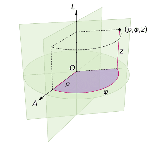

what does "a" represent as you say p>a?
and looking at the cylindrical coordinate system, ## \rho ## is going to be the radius of the cylinder, however you have already used a different letter b for this, so I am getting confused with the symbols. It would be helpful to have a clear description of what you have used for what in order to have some clarity.
  • #73
## a ## is the radius of the cylindrical magnet, and ## b ## is the radius of the coil. ## \rho ## is an arbitrary radius in the cylindrical coordinate system.
If you look at the integrals of the "link" of post 25, they introduce ## a ## as the limit of the ## R \, dR \, d \Phi ## integration over the endface of the magnet. Meanwhile, I introduced the letter ## b ## for the radius of the coil in post 45.

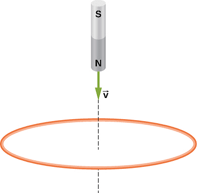

  • #89
Einstein44 said:
So I am going to start from the beginning now:
My aim is to find the induced emf as a cylindrical N42 magnet falls through a coil of N loops.
To calculate this I use Faradays Law.
Now for that, I need to find the magnetic flux in the first place using the equation:
$$\phi =\oint BdAcos\theta$$
This is why I am now trying to find B for the magnet, in order to work out this problem.
I am attaching a picture below that might perhaps help with visualisation.
So yes, indeed involves a moving magnet.
So now that the issue of calculating the field is being addressed it is time to think about the setup of the problem as a whole. You might set it up something like this diagram where the center of the magnet is some distance, say ##nL## above the plane of the loop which is fixed. We have discussed getting the flux at anyone time above but how do you think you can calculate the change in flux as time becomes involved?

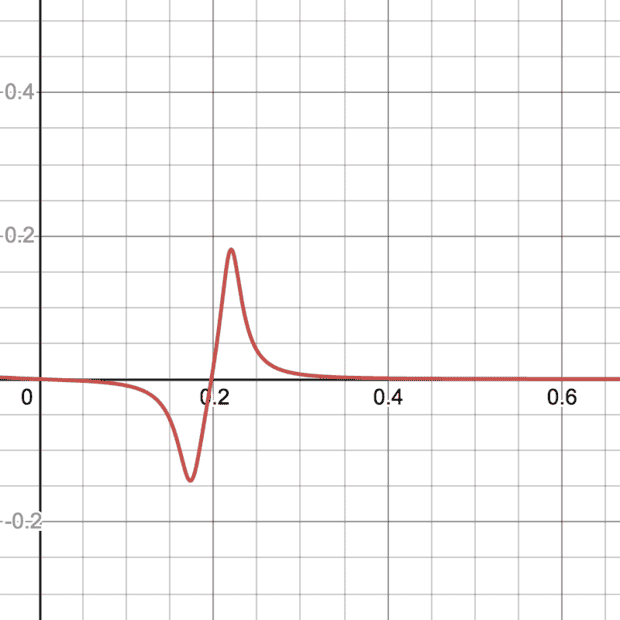

OK so here is my less-than-professorial attack on this problem. Please correct any flubs. An N32 magnet is typically near saturation and the surface flux density is roughly 1-2 Tesla. A Tesla is a Weber/m^2, so for a 1 cm cube magnet the flux from one pole face will be ~ ##10^{-4}## Weber. Rotated appropriately at the center of a loop at ##\omega=10s^{-1}## will produce an EMF of ~1 mV that is periodic (roughly sinusoidal as discussed in prior post previously alluded to)
Thought it was time for a sanity check for the OP (did we pass?)

It's a bar magnet falling through a loop.
