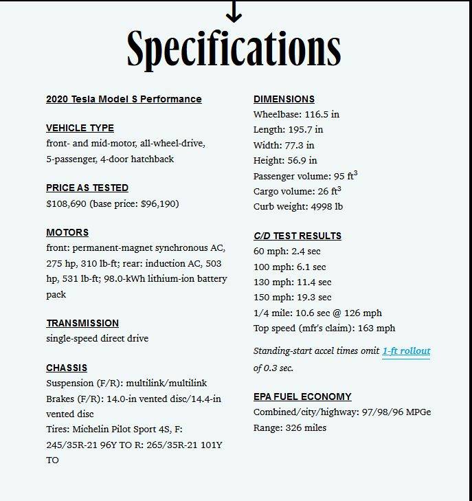

Attached is the Tesla spec sheet. I used 660 n-m (488 ft-lb) not a big difference to explain the discrepency.

Which one has 2.4 s and 660 N.m ?
How many wheels are driven in your Tesla ?
