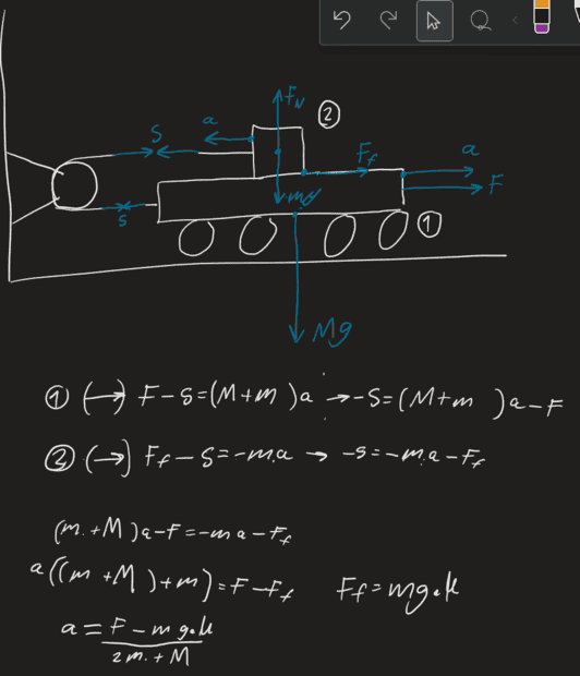

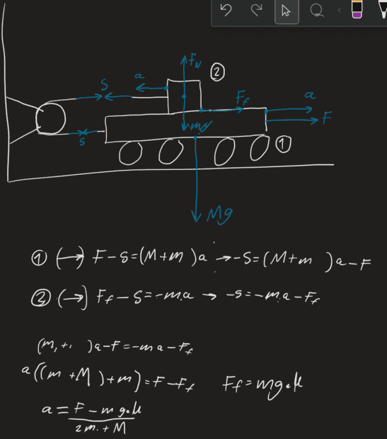

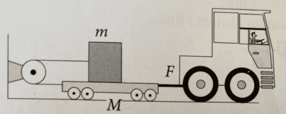

On a trailer (mass M), there is a box (mass m). A rope runs from the box over a fixed pulley to the back end of the trailer. A pulling force F acts on the trailer. There is friction between the box and the trailer. The trailer is considered to be moving easily on the ground. Calculate the acceleration of the box relative to the ground (see picture for better understanding of question under Attempt at a Solution).
f = (mu)*FN, f=ma
Question picture:
My solution:
Where:
S is the lineforce
Ff is the force as a result of friction
a is the resulting acceleration
F is the acting force
The answear is supposed to be a=(F-2mg(mu))/(m+M)
Any idea what i could have missed?
Thanks for your help on beforehand!

Please take a few moments to learn how to use Latex for posting the mathematics on this site. Your hand writing is not particularly neat. It also helps would be helpers quote where may be wrong directly. The pictures are ok for diagrams, not for the math.
Also you should have separate FBD's for the box and the trailer, and fix a coordinate system ( I would suggest at the pulley ).
Likes MatinSAR, Heexit and kuruman
You seem to think that equation 1 is what you get for the trailer + box system. It is not because friction is not taken into account. Does it make sense that the equation for the two-component system is the same whether friction is there or not?
Write separate equations from separate FBDs as @erobz suggested. When you add them, you should get the correct equation for the trailer + box system and it will not be what you have now.
Likes MatinSAR, Heexit and erobz
Remember that friction acts on both surfaces (the box and the trailer)

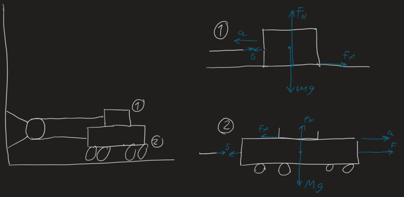

As per request, here comes the new improved FBD's:
And the following equations:
1. ##F_f-S=-ma\Rightarrow -S=-ma-F_f##
2. ##F-S-F_f=Ma\Rightarrow -S=Ma-F+F_f##
This gives:
##-ma-F_f=Ma-F+F_f##
##-a(M+m)=-F+2F_f##, where ##F_f=mg\mu##
##a=\frac {F-2mg\mu} {M+m}##
Thanks for your time and advice!

For future reference, you are "freeing" the trailer of the box, replacing the box with forces it produces on the trailer. There shouldn't be a partial box in the trailers FBD, nor should there be a partial trailer in the boxes FBD.
Meh. It's an artist's conception, intended to visually depict the source of the normal force ##F_n## on the bottom of the box and the [identically named] normal force ##F_n## on the top of the trailer.
I expect that is also the reason for depicting the string on the left of both drawings. I did find the arrow on the end of the string to be off-putting. However, I think I grasp the intended meaning. The depiction there is of an interface between string and box (or string and trailer). The string is being pulled rightward by the box/trailer. Hence the right arrows. The box/trailer is being pulled leftward by the string. Hence the left arrows.
I get it’s just a drawing, but when we are examining internal forces in materials we slice them, making the internal forces external to the slice. To me, leaving part of the box (or part of the trailer) hasn’t properly externalized the internal force of friction in this system. That’s why I mentioned it.
I would agree with @jbriggs444 on this one. Drawing part of the source as a reference becomes necessary especially in cases of circular motion on surfaces such as a mass sliding on a track. The contact force is centripetal or centrifugal depending on which side of the track the mass is riding. So the curvature of the track is needed for drawing the contact force and the acceleration consistently with the given physical situation. Personally, I draw such reference surfaces in dotted lines to indicate their evanescent nature.
Dotted lines are a good compromise (in my opinion), I just wasn’t sure the OP was fully getting that concept given the first “FBD”. If they were just being "efficient" by not separating the bodies, it was that efficiency that lead to the error (I think).
