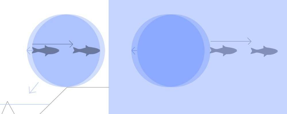

If there is no friction, can the hamster succeed ?+
  • #46
A.T. said:
Without the possibility to move the CoM relative to the ball you cannot "shove" or "rock" the ball around.
I'm having an extremely difficult time conceptualizing this. My mind keeps visualizing 2 "fish" which are neutrally buoyant swimming downwards towards a "see saw" at the bottom of a pool (or rod balanced on a fulcrum). They both hit at the same time but one fish is traveling downwards at twice the velocity of the other fish. Is the center of mass at time of impact balanced? Will the "see saw" or balanced rod deflect predictably one way or the other upon impact?
  • #47
No friction with the ground means no external horizontal force, so the CoM will not move horizontally, but the contact point can slide back and forth.

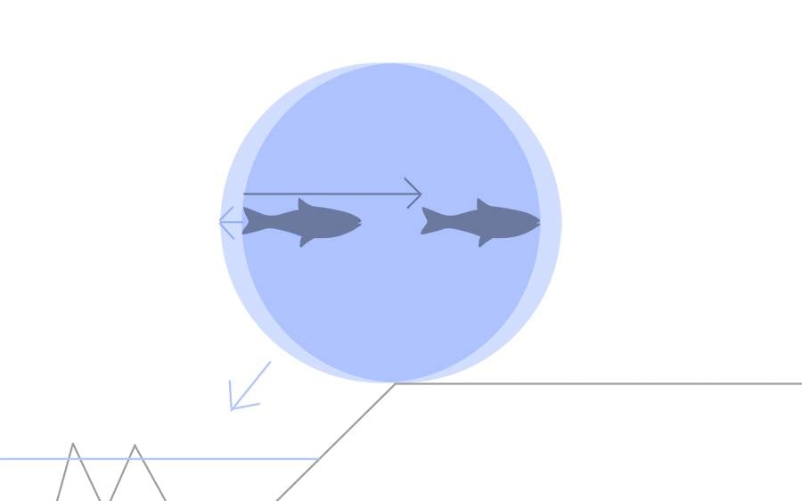

  • #49
This is not a closed system, because the container is in contact with the floor. As long as the fish can swim away from the center of the ball and induce a circular flow of water, then the angular momentum of the water and ball have to be offset by the angular momentum of the Earth (the only point of interaction is at the contact point between ball and floor).
If the experiment was tried in space, free from any external forces, then the center of mass of the now closed system could not be moved.
I don't see how the fish in a ball differs that much from any other "self-propelled" vehicle, such as a unicycle, bicycle, motorcycle, car, ..., other than it's inefficient.
update - A better explanation is that the fish can swim forwards in the water to keep the center of mass of ball, fish, and water in front of the contact point. Then the pull of gravity and the upwards force from the floor combine to exert a forwards torque on the ball.

DaveC426913 said:
I'm not good at this conservation of angular momentum, but won't the fish's angular momentum in one direction be exactly canceled by the water's momentum in the opposite direction? This isn't like other situations, where a rider could "grab" the machine and manipulate it.
I updated my answer with a simpler explanation unrelated to angular momentum.
The fish swims in place at some fixed (relative to ball) point in front of and above the contact point of the ball. I'm assuming there's enough friction or something like vanes between the water and interior surface of the ball so that the spinning water also spins the ball, so there is resistance to the water spinning, at least while the ball is accelerating.
Since the fish is in front of the contact patch, then the center of mass of the ball, fish, and water is also in front of the contact patch, and gravity's downward pull at the center of mass and the floor's upward push at the contact point coexist with a forwards torque on the ball.
This situation is similar to a ball with an internal electric motor inside, except for the interface between the water and the interior surface of the ball. Both require the center of mass to be kept in front of the contact point in order to accelerate. Once at speed, then there only needs to be enough torque to overcome rolling resistance.

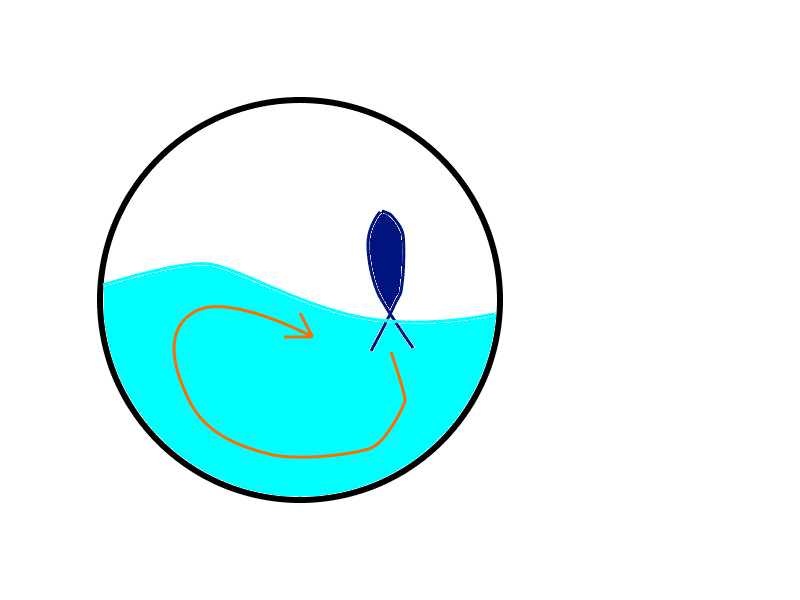

[Negative pressure is not unreasonable. If the water is under atmospheric pressure we can have up to 15 psi of negative gauge pressure before we hit zero absolute pressure. Even negative absolute pressure is physically reasonable. Water has surface tension. In the absence of nucleation sites, it will resist forming voids. A quick trip to Google yields http://discovermagazine.com/2003/mar/featscienceof which is less than authoritative, but quite readable. This hit is more authoritative]
A football filled with water (just the top pole cut off) and an angled coat hanger with a make shift fish on the end. Anything that can go on the end of the cost hanger but still get through the north pole. Once in rotate slowly in the horizontal plane.
Possible issues are the symmetry of the ball is reduced (a little) so centre of gravity a little skewed. Also some extra turbulence from the wire but a thin wire should not impact too much.
I think it's better

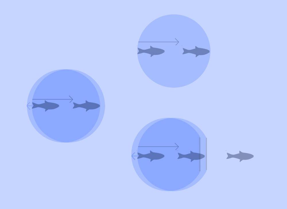

  • #64
jbriggs444 said:
If the water plus fish fill the ball then, when the fish pushes off, water fills the void he leaves behind. The total momentum of fish plus water remains constant and zero. Accordingly the momentum of the ball is zero.
So if the ball is submerged in an aquarium, with a fish inside the ball and a fish outside the ball...
The fish outside the ball pushes its tailfin off the ball deriving an impulse in one direction, and the ball moves the opposite direction.
Scenario 2 is when the fish inside the ball pushes its tail off the glass with the same amount of force. If I understand correctly you are saying in Scenario 2, the ball won’t translate by even a millimeter at any point in time.
  • #65
Correct.

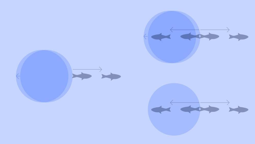

So the frontal area of the fish, its drag coefficient and fluid density of the water its submerged in has no bearing? I thought if we were to reduce the frontal area and drag coefficient of the fish—
then fish (as opposed to the water) retains more kinetic energy after the fish travels X distance, after it pushes off from the side of the ball with its tail fin.
