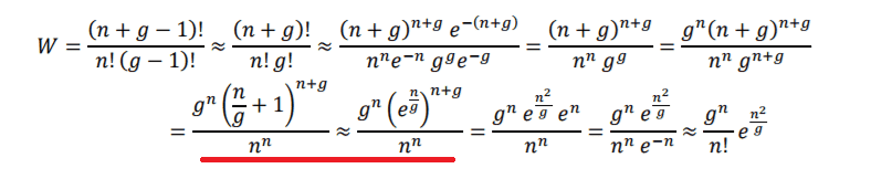

NFuller said:
Strictly speaking this is true. The actual number of states valid for even small numbers of identical particles is
$$W=\frac{(N+g-1)!}{N!(g-1)!}$$
where ##g## is the number of states. For the case given above this means
$$W=\frac{(2+2-1)!}{2!(2-1)!}=3$$
In the high temperature limit where ##g>>1## and the low density limit where ##g>>N##, the expression above can be simplified to give the standard Boltzmann counting
$$W=\frac{g^{N}}{N!}$$
Do you have a pdf or a link for the approximation you could send easily?
I can't quite get it right.
About $$W = \frac {g^N} {N!}$$ This is actually not the number of ways of distributing N distinguishable particles among g states. The correct expression for distinguishable particles is $$W = g^N$$
To me it seems that Bose-Einstein does not give Boltzmann for g>>N>>1, but something similar to Boltzmann, only for indistiguishable particles
