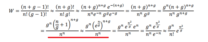

I've tried to fill in the gaps of this derivation (see appended pdf) and I don't get the same result. Am I making a mistake?
It looks like something went wrong here:
After factoring out the ##g^{n}## the expression should read as
$$\frac{g^{n}\left(1+n/g\right)^{g}}{n^{n}}$$
then use the approximation
$$\left(1+\frac{n}{g}\right)^{g}\approx e^{n}$$
for ##g>>n##.

I really don't see a mistake there, I'm afraid. I'm not actually factoring out gn. What happens to the n in the exponent n+g in your result?
  • #73
I think this is how it is justified:
$$\frac{(n+g)^{n+g}}{n^{n}g^{g}}=\frac{(n+g)^{n}(n+g)^{g}}{n^{n}g^{g}}\approx\frac{g^{n}(n+g)^{g}}{n^{n}g^{g}}=\frac{g^{n}g^{g}\left(1+n/g\right)^{g}}{n^{n}g^{g}}$$
$$=\frac{g^{n}\left(1+n/g\right)^{g}}{n^{n}}\approx\frac{g^{n}e^{n}}{n^{n}}\approx\frac{g^{n}}{n!}$$

Thanks, that must be it. I didn't see the additional approximation.
