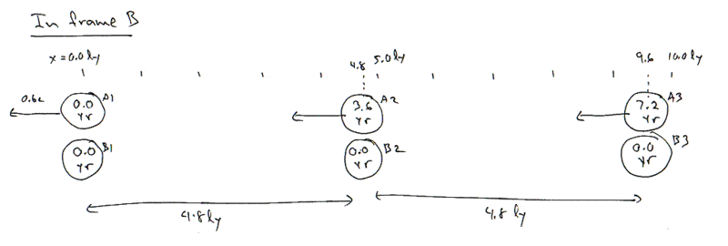

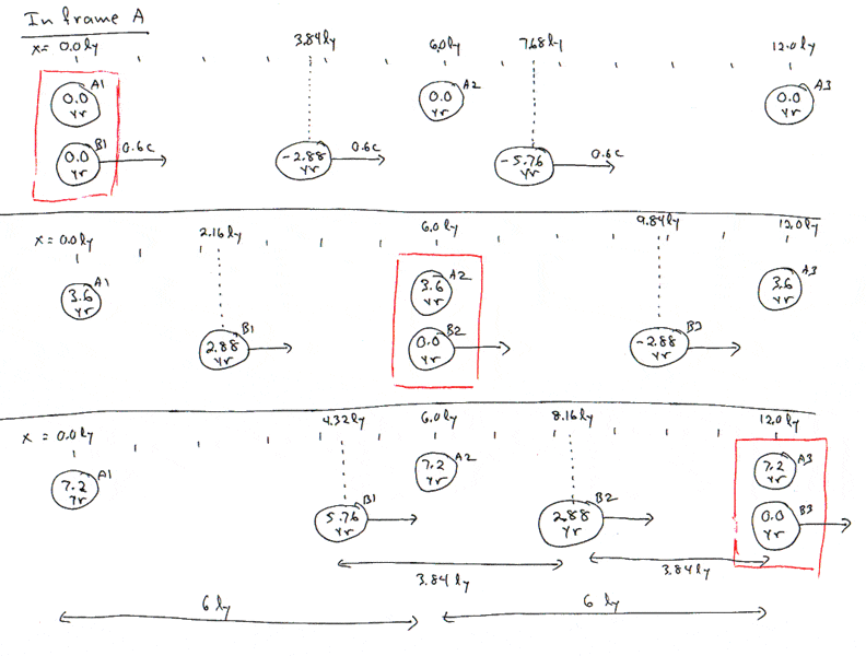

OK, let's say our ship departs Earth and travels at 0.6c for 10 years in the Earth's frame, then turns instantaneously and travels back at 0.6c for another 10 years in the Earth's frame. In the Earth's frame, the time dilation factor is \sqrt{1 - 0.6^2} = 0.8, so the traveling twin's clock will only tick (10 years)*(0.8) = 8 years during the outbound leg, and (10 years)*(0.8) = 8 years during the inbound leg, so when they reunite the Earth's clock will show 20 years have elapsed while the ship's clock only shows 16. Note that both the 10 years and the 0.8 time dilation factor were calculated solely from the perspective of the Earth's inertial frame.
Now let's analyze the problem in a different inertial frame--the frame where the traveling twin is at rest during the outbound leg. In this frame, the Earth will be moving away at a constant speed of 0.6c, while the ship will first be at rest for 8 years, during which time the Earth has moved away a distance of (8 years)*(0.6c) = 4.8 light years, and its clock has advanced by (8 years)*(0.8) = 6.4 years, while the ship's clock has advanced forward by 8 years since it is at rest. Then after 8 years the ship will accelerate instantaneously, and using the velocity addition formula we know its speed in this frame after acceleration will be (0.6c + 0.6c)/(1 + 0.6^2) = 1.2c/1.36 = 0.88235c. Since the Earth is 4.8 light years away but only moving at 0.6c, the time for the ship to catch up can be found by solving for t in 4.8 + 0.6t = 0.88235t, which gives t = 17 years in this frame. During this time, the Earth's time dilation factor will still be 0.8, while the ship's will be \sqrt{1 - 0.88235^2} = 0.4706, so the Earth's clock will have advanced forward by (17 years)*(0.8) = 13.6 years while the ship's clock will have advanced forward by (17 years)*(0.4706) = 8 years. So, by the time the ship catches up to the earth, the Earth's clock will have advanced forward by the 6.4 years of the outbound leg plus the 13.6 years of the inbound leg, while the ship's clock will have advanced by the 8 years of the outbound leg plus the 8 years of the inbound leg. So, we find that the Earth's clock had advanced 20 years while the ship's clock has advanced only 16, just as we found in the Earth's frame.
We could also analyze everything from the point of view of the frame where the ship is at rest during the inbound leg. This will just be the mirror image of how things looked in the outbound rest frame--during the outbound leg, the Earth is moving at 0.6c while the ship is moving at 0.88235c in the same direction, which lasts for 17 years, then the ship instantaneously accelerates and comes to rest while the Earth continues to approach it at 0.6c from a distance of 4.8 light years, catching up to it after 8 years in this frame. And again, in a mirror image of the analysis in the outbound rest frame, the ship's clock elapses (17)*(0.4706) = 8 years during the outbound leg and (8)*(1) = 8 years in the inbound leg, while the Earth's clock elapses (17)*(0.8) = 13.6 years in the outbound leg and (8)*(0.8) = 6.4 years in the inbound leg, so you again predict the ship's clock elapses a total of 16 years while the Earth's clock elapses a total of 20 years.
Now look what would happen if you tried to switch frames in mid-problem, without worrying about simultaneity issues. Start out using the outbound rest frame during the outbound leg, and you'll conclude that at the moment before the ship does its instantaneous acceleration, the ship's clock reads 8 years and the Earth is 4.8 light years away, its clock reading 6.4 years. Now if you switch to the inbound rest frame, and you don't realize that because of the different definition of simultaneity the Earth should "jump" to reading 13.6 years, then you'll mistakenly continue to think that at the beginning of the inbound leg the Earth's clock reads 6.4 years, and since the inbound frame says the ship is at rest during the inbound leg while the Earth is approaching it at 0.6c from 4.8 light years away, in the inbound frame the ship's clock must advance by 8 years during the inbound leg and the Earth's clock must advance by (8)*(0.8) = 6.4 years, so you would conclude the Earth's clock only read 6.4 + 6.4 = 12.8 years when the ship returned? But this answer contradicts the answer you get when you stick to a single inertial frame throughout the problem, whether the Earth rest frame, the inbound rest frame or the outound rest frame; you get the wrong answer if you try to "patch together" different frames in mid-problem this way, without taking into account discontinuous jumps in clock time due to the frames defining simultaneity differently.

Although the time dilation factor as measured in a given inertial frame is only a function of a clock's speed in that frame, not its velocity, a frame can only qualify as "inertial" in the first place if it is moving at constant velocity, not just constant speed. So even though the instantaneous acceleration means the traveling twin never changed speeds in the Earth's inertial frame (although he did change speeds in every other inertial frame, like the outbound rest frame), he did not stay at rest in a single inertial frame throughout the journey.
Analyzing the triplets problem wouldn't differ much from the twins problem. Let's again assume that in the Earth's frame, the two traveling triplets move at 0.6c, and turn around after 10 years. In the Earth's frame, each traveling triplet ages (10 years)*(0.8) = 8 years during their outbound legs, and another 8 years during their inbound legs, so that they have both aged 16 years when they return while the Earth twin has aged 20 years.
Now look at things from the perspective of an inertial frame where one of the triplets is at rest during the oubound leg. In this frame, for the first 8 years this triplet (call him A) will be at rest, while the earth-triplet (call him B) is moving away at 0.6c and the third triplet (call him C) is moving away at (0.6c + 0.6c)/(1 + 0.6^2) = 0.88235c. Since C's clock is ticking slow by a factor of 0.4706 in this frame, and he won't accelerate until 8 years have passed on his own clock, he won't turn around until 8/0.4706 = 17 years have passed in this frame; when he does turn around, he'll be at rest in this frame, and at this moment the distance between him and the Earth is (17 years)*(0.88235c - 0.6c) = 4.8 light years. The Earth will continue to approach him at 0.6c after this point, reaching him after an additional 4.8/0.6 = 8 years in this frame. And when A turns around after 8 years, he is now moving in the direction of the Earth at 0.88235c, with the Earth having moved a distance of (8 years)*(0.6c) = 4.8 light years in those 8 years. The time for A to catch up to the Earth is given by 4.8 + 0.6t = 0.88235t, or 17 years. So in this frame A starts out at rest, accelerates after 8 years, then takes another 17 years to catch up to earth, while C starts out at high speed, accelerates to rest after 17 years, and then the Earth takes an another 8 years to catch up to him, meaning all three twins reunite after 25 years have passed in this frame.

For the benefit of all.
Here's a portable document file (PDF) I drafted a number of years back. It's a Minkowski worldline diagram of the twins scenario. A spacetime diagram paints a 1000 words.
This scenario is called "the handoff technique". Minkowski diagrams are truly designed to represent inertial reference frames, however the effects of acceleration may be extrapolated.
This scenario has 2 figures, O stationary and A stationary ...
1. Observer O & A flyby event, where they align their clocks at flyby.
2. Observer A & C flyby, whereby C aligns his clock to A's.
3. Clock comparison at final C & O flyby.
It represents the equivalent of an observer A departing from observer O with clocks aligned, then immediately returning at some point back to O for clock comparison, where accelerations are considered instantaneous.
I also show an observer B who represents a mirrored image of observer A, although this may be ignored far as the twins scenario is concerned. I use v=0.866c outbound & inbound since gamma is conveniently = 2.

I'd modify that to say Minkowski diagrams are designed to represent inertial reference frames, but within such a frame you can certainly draw in the non-straight worldline of an accelerating object.
Would it be possible for you to translate the diagrams into jpgs or gifs? I have a mac and I don't know what application to use for the doc you attached. But if it'd be much trouble don't worry about it, presumably most other people don't have this problem.
  • #70
done.

  • #78
Mikeh,
I just retweeked it again, so please reprint the updated (newer) rev b version I just posted. You got the 1st rev b. See ...
In this 2nd rev c version, I added a line-of-simultaneity in the bottom figure. This in relation to JesseM's point regarding synchronized clocks appearing to lag each other in clock readouts per a moving observer vantage. You might want to print this post out when looking at the figure printout...
The top figure shows the O stationary perspectve. O's line-of-simultaneity is horizontal, and 12:34am-C, 1:09am-O, 12:34am-B all ly on the horizontal black line. A horizontal line-of-simultaneity is a line representing NOW across space for the stationary observer perspective at some moment. So in this case, O always sees B & C clocks aligned in time readout at any moment, ie they appear synchronized per O.
The bottom figure shows the A stationary perspective. O's line-of-simultaneity is slanted because O is in motion with slanted worldline, and 12:34am-C, 1:09am-O, 12:34am-B all ly on the slanted gray line. This represents O's sense of NOW at 12:09am-O. A slanted line-of-simultaneity is a line representing NOW across space for the moving observer perspective. Note that the observers C,O,B times which intersect this slanted line-of-simultaneity match that of the upper figure!
To determine a moving observer's line-of-simultaneity, draw his x'-axis such that the angle it makes with the 45 deg light beam is identical to the angle his slanted worldline makes with the 45 deg light beam, but on the other side of the light beam. This is to say ...
the faster an observer moves, the more slanted his worldline becomes. Light paths are always 45 deg on Minkowski worldline diagrams, since they travel one unit space per 1 unit time, and units of space & time are set equal (normalized), and so speed c=1. The more a moving observer's worldline tilts away from your own stationary vertical worldline (ie your time axis), the more his x'-axis tilts upward toward the 45 deg ray path from your x-axis. That x'-axis is his line-of-simultaneity, his sense of NOW!
Note that in the top diagram, O stationary, the observer A & B clocks read the same in that O instant of 1:09am-O. In the bottom A stationary figure, observers B & C never possesses the same time readouts in any observer A moment, because B & C are in motion. The most aft clock (C's) reads well ahead of the foremost clock (B's). A's line-of-simultaneity is of course horizontal in the lower figure, since that's an A stationary vantage. Lines-of-simultaneity are your spatial axis, so x-axis for one guy, x'-axis for the other guy. Minkowski spacetime diagrams portray 1-space vs time.
pess
  • #79

For what it's worth, here are a couple of diagrams of the situation being discussed. The simpler one is frameB.gif, which shows the two sets of clocks passing each other simultaneously in frame B. I've let this be time 0 on the B clocks, and I've arranged things so clocks A1 and B1 both read zero. A2 and A3 have nonzero readings because I've assumed that the A clocks are synchronized in frame A.
In frameA.gif, I show the two sets of clocks at three different times in frame A, namely the points in time at which each of the three pairs of A & B clocks pass each other.
I think this is the same situation that M1keh and JesseM are discussing, except that I have not synchronized B1, B2 and B3 with A1, A2 and A3 when they pass each other in frame B, because that would put B1, B2 and B3 out of sync with each other. The A clocks are synchronized in A, and the B clocks are synchronized in B, as is usual in thought experiments like this.

Thanks. Top diagrams. Like the way you've scanned them in and attached them.
One question first. Why are the diagrams for A's f.o.r and B's f.o.r so different ? What's so 'special' about B's f.o.r ?
In B's f.o.r the A's are traveling at 0.6c, exactly the same as the A's view of the B's in their f.o.r ?
Why the difference ?

You specified that the "A clocks" and the "B clocks" should have equal spacings in frame B (4.8 ly), so that in frame B at one particular moment, which I chose to be time 0 in frame B, the following three events would occur simultaneously:
A1 passes B1;
A2 passes B2; and
A3 passes B3.
Therefore I could draw a single diagram that shows all three events happening at time 0 in frame B.
Because of relativity of simultaneity, these three events do not occur simultaneously in frame A. Therefore I had to make three diagrams for frame A, representing three different times in frame A:
time 0, when A1 passes B1;
time 3.6 years, when A2 passes B2; and
time 7.2 years, when A3 passes B3.
