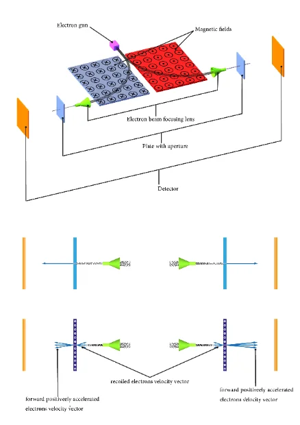

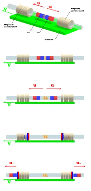

1. The Big Idea:
According to Einstein’s relativity, all motion is relative. You can’t tell if you’re moving at a constant velocity without looking outside. But what if there is a universal “rest frame” (like the old idea of the “ether”)? This experiment tries to find out by looking for tiny, directional differences in how objects move inside a sealed box.
2. How It Works: The Two-Stage Process
Imagine a perfectly isolated spacecraft (our lab) moving through space at some unknown speed V.
Stage 1: Symmetric Launch
  • Inside the craft, we use a spring or magnets to shoot two identical metal balls in opposite directions.
  • From inside the craft, everything looks symmetric: both balls fly away at exactly 10 m/s in opposite directions.
Stage 2: The Key Test (Asymmetric Acceleration)
  • Now, each ball flies into a separate magnetic tunnel. These tunnels are identical and give each ball an identical extra push (a constant force over a fixed distance) in the direction they are already moving.
  • According to standard relativity, since the experiment is symmetric from inside the craft, both balls should get the exact same extra speed boost (say, +5 m/s).
But here’s the catch: If the craft is absolutely moving at speed V, then from outside:
  • The forward ball is already moving faster: its speed is (V + 10) m/s
  • The backward ball is moving slower: its speed is (V - 10) m/s
Because of this, the time each ball spends inside its magnetic tunnel is different:
  • The faster (forward) ball zips through quickly.
  • The slower (backward) ball takes longer to get through.
A longer time under the same force means a bigger push (a larger impulse). So:
  • The backward ball gets a larger speed boost.
  • The forward ball gets a smaller speed boost.
The Prediction: When we measure them from inside the craft, the two balls will no longer have the same speed! The one shot backward will be moving slightly faster relative to the craft than the one shot forward. This breaking of symmetry would be evidence for absolute motion.
3. What We Measure:
The experiment looks for three things:
  1. Velocity Difference: A tiny difference in the final speeds of the two balls.
  2. Timing Difference: A difference in how long each ball was pushed in its tunnel.
  3. Craft Acceleration: Because the pushes aren’t equal and opposite, the whole spacecraft would get a tiny kick forward.
4. Why This Might Work:
It avoids the usual tricks that hide absolute motion (like time dilation) because it compares two events that happen at the same time and in the same place (inside the lab). It relies on a simple rule: The longer a force pushes, the more speed it adds.
5. My Questions for You:
  • Feasibility: Is it possible to measure the tiny time differences (probably nanoseconds) this would create?
  • Hidden Flaws: What could go wrong? Could magnetism or vibrations accidentally create a false result?
  • Interpretation: Does this logic make sense, or have I missed a reason why relativity would still make the outcomes equal?
Thanks for taking the time to read this. I’m eager to hear your thoughts and criticisms.

Basically, we are applying the same force over the same distance and therefore doing the same work on both projectiles. But here’s the catch: from the rest-frame perspective, the projectile velocities will be and . That seems to imply different interaction durations with the same force, which would cause different impulses.
However, by the principle of relativity, all physics is frame-dependent, so the interaction durations in the proper frame of the experiment must come out the same and produce the same impulse. Any apparent difference in an external frame is compensated by the way fields and lengths transform.
Up to now, all experiments have only failed to detect a rest frame; none have directly ruled it out in this way. This kind of setup would be the first to explicitly invalidate the idea of a rest frame. If that’s the case, then quantum gravity theories should focus only on scenarios where Lorentz symmetry is not fundamental but instead breaks emergently at high energies.
If the lab frame says that the particles have equal and opposite velocities and pass through mirrored EM fields for equal durations then any other frame will say that the velocities are different, the EM fields are not mirror symmetric, and the interaction times are different.
Note that both EM theory and relativistic dynamics are Lorentz invariant, so you cannot predict a violation of Lorentz covariance using these theories. If you think you have, you are doing something wrong. You would have to propose a new theory and use that or refer to an actual experiment and show that its results are inconsistent with existing theory.

I totally agree with you: in other frames the interaction durations will look different, while in the lab frame everything is symmetric. However, proponents of a universal rest frame would argue that those differing interaction times must also show up inside the inertial frame, because an absolute rest frame would dictate absolute time. That’s why I see this experiment as giving a binary outcome: either the results remain symmetric, consistent with relativity, or they don’t—which would point to the existence of a rest frame.
But the results won't be exactly symmetric due to experimental error. So how big a deviation can you tolerate? To answer that question you need to know what the prediction of a non-Lorentz covariant theory is and what your expected errors are. Only then will you know whether the experiment is worth doing.
Does a non-Lorentz covariant theory even predict a non-symmetric result here? You haven't shown that it does, just waved your hands a lot.
Note also the link in post #2, which points to existing tests of Lorentz covariance.
Likes Asaad-Hamad and pines-demon
That's what the Michelson-Morley experiment did. If there were a universal rest frame (in which Maxwell's laws held), then the speed of light would be different in different frames of reference and this would show up in their interferometry experiment. It didn't. From this Einstein concluded in his 1905 paper:
The launches are symmetric, right? I don't understand how this is different from what happens to the balls later when they are sped up by your identical magnetic tunnels. If the magnetic tunnels have asymmetric effects on the balls then so do the launches.
Thank you for this crucial point. You are absolutely correct that from the platform's inertial frame, the analysis must be self-contained, and in that frame, the setup is symmetric, leading to the expectation that $\Delta t_1 = \Delta t_2$.
The purpose of the long linear accelerator version is to create a scenario where this symmetry could potentially be broken if a fundamental rest frame exists. The thought experiment hinges on a specific interpretation of the kinematic equation.
The argument is this:
  1. The kinematic formula $d = v_0 \Delta t + \frac{1}{2}a (\Delta t)^2$ is a statement about distances and times in a specific frame.
  2. If a rest frame exists, the initial velocity $v_0$ for each projectile in that absolute frame is different: $v_0 = V + u$ for one and $v_0 = V - u$ for the other.
  3. The distance $d$ is the physical length of the accelerator. If this length is set and measured in the platform frame, and if length contraction is a real physical effect, then this platform-defined distance $d$ would correspond to a different length in the rest frame. However, the experiment is designed to apply a force over this fixed, platform-measured distance.
  4. Therefore, from the rest frame's perspective, the time $\Delta t$ for a projectile to be accelerated over that fixed platform-distance $d$ would depend on its absolute initial velocity, leading to:
    $$\Delta t_1 \approx \frac{d}{V+u} \quad \text{and} \quad \Delta t_2 \approx \frac{d}{V-u}$$
  5. This results in an impulse asymmetry $J = F \Delta t$.
The key question the experiment tries to pose is: Does the duration of this physical process (accelerating over a distance $d$) depend on the absolute state of motion, and would this dependence manifest in a local measurement (e.g., a different final relative velocity for the projectiles)?

Dale said:
This kind of setup is already done all the time. What you describe is any particle accelerator that uses counter-rotating beams. If the velocities differed as you suggest then the beam timing would be off and you would lose your particle bunches.
This behavior is not untested. It is tested so well that governments are willing to spend billions of dollars on technology that depends on precisely on what your design would test
You are correct that in a closed cycle (e.g., accelerating and then decelerating a particle in an accelerator), the effects cancel out, preserving symmetry. This is why no anisotropy is observed in standard accelerator operations.
The proposed anisotropy is path-dependent, not velocity-dependent. It arises exclusively during positive acceleration (increasing the magnitude of velocity) applied to an already-moving body.
The mechanism is:
  1. Work is path-independent: $W = \int \vec{F} \cdot d\vec{x}$ depends only on the force and the distance, hence $W$ is identical for both directions.
  2. Impulse is path-dependent: $J = \int \vec{F} dt$ depends on the time spent under force.
  3. For a fixed distance $d$, the interaction time is $\Delta t \approx d / v_{avg}$. A body with a higher initial absolute velocity ($V+u$) traverses the distance $d$ faster than one with lower velocity ($V-u$).
  4. Therefore, $J_{\text{forward}} < J_{\text{rearward}}$ for the same $W$.

If the inertial frame is moving at 100 m/s in rest frame, each projectile mass equal 1 kg, initial launch caused 10 m/s relative velocities inside the inertial frame. Magnetic accelerator applies 500 N over 0.1 m. Then the difference in projectile's velocities will be 0.1 m/s. The interaction durations are 0.9 and 1.1 ms. But at absolute velocity of 400 km/s the durations will be 0.24999 and 0.25001 micro seconds. That's why using electron beam might be more practical solution, otherwise we will need long magnetic accelerator with high energy for the projectiles

Here is the detailed math:
In all standard experiments (e.g., collisions, springs between objects at rest), applying equal work ($W = F \cdot d$) results in equal impulses ($J = F \cdot \Delta t$) and perfectly symmetric outcomes within the inertial frame.
This experiment is designed to create a scenario where that symmetry could break. The core mathematical argument, from the hypothesized rest frame perspective, is as follows:
The interaction time for a constant force $F$ over a fixed distance $d$ is governed by the kinematic equation, where $v_0$ is the initial velocity in the rest frame:
$$\Delta t \approx \frac{d}{v_0}$$
For the two projectiles with different absolute velocities, this predicts:
$$\Delta t_1 \approx \frac{d}{V+u}, \quad \Delta t_2 \approx \frac{d}{V-u}$$
This results in fundamentally different impulses for the same work:
$$J_1 = F \Delta t_1 = \frac{F d}{V+u}, \quad J_2 = F \Delta t_2 = \frac{F d}{V-u} \quad \Rightarrow \quad J_2 > J_1$$
The resulting predicted velocity anisotropy, measured in the platform frame, would be:
$$\Delta u_2 - \Delta u_1 = \frac{J_2 - J_1}{m} = \frac{F d}{m} \left( \frac{1}{V-u} - \frac{1}{V+u} \right) \approx \frac{2 F d u}{m V^2}$$
For a macroscopic setup at $V = 400$ km/s, this effect is minuscule
The uniqueness of the experiment is its claim that the same local work $F \cdot d$ could produce different local impulses ($J$), leading to a measurable asymmetry within the lab frame. This would violate the standard expectation that all local physics is self-contained and symmetric.
The full mathematical derivation, including numerical examples and an analysis of both mechanical and microscopic versions, is quite lengthy. I have attached the relevant section as a PDF for anyone who wishes to examine the details in full.
