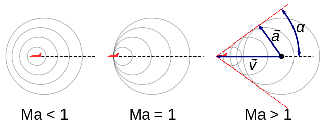

OK, I'm chiming in. Maybe I don't understand what some are saying - and I'll repeat the same thing - or I don't understand sound waves.
First, there are pressure waves and sound waves. Although similar (they both travel at the same speed, i.e. speed of sound), they are two very different things.
Pressure waves
Pressure waves are much much stronger than sound wave and they are an aerodynamic phenomena, i.e. an object moving into a fluid. As soon as there is a pressure variation, there is a pressure wave sent at the speed of sound to «inform» the fluid ahead that a pressure change is coming. The pressure variation is determined mostly by the object' shape.
When the object goes faster than Mach 1, then the pressure waves sent in front of the object «pile up» creating a shock wave, releasing an enormous amount of energy, leading to a sonic boom. Similarly, a negative pressure wave (think vacuum) is sent behind the object which leads to a second «pile up», thus a second sonic boom. Note that it is possible to design an object that do not produce those [external] shock waves and sonic booms (Busemann's Biplane). Also, there are 2 major sonic booms with an airplane, but there are others - weaker - for all protuberances of the airplanes:
(source)​
Sound waves
When you consider sound waves only, for an object going faster than Mach 1, the same thing should happen, but with far less energy release. In front of the Mach cone, no sound can be heard. Why? Because all the sound waves emitted are «piling up», which should create a «mini» sonic boom (again, sound waves are orders of magnitude below pressure waves). So you will never hear music playing backward, except maybe in the thickness of the shock waves (I don't know about sound waves, but with pressure waves, the thickness of a shock wave is about 200 nm).
Behind the shock wave, you will only have the «rear» portion of the sound waves emitted, so the sound waves will be in the correct order (no «backward playing») with a phase shift leading to a lower frequency (like a moving car siren).
Summing it up (not taking pressure waves into account):
  1. I see the supersonic music box coming towards me and hear nothing;
  2. As it passes by, I hear a mini sonic boom;
  3. As I look at the supersonic music box going away, I hear the music playing in a lower frequency.
Does that make sense or am I missing something?

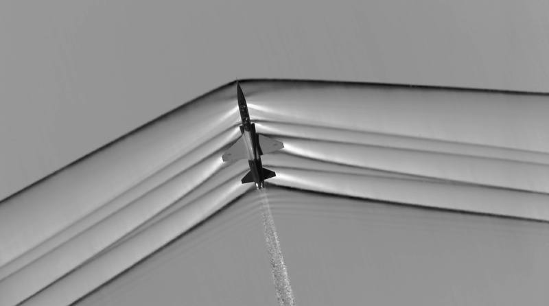

On a bit of a side note, the boom you typically hear from a supersonic jet at a relatively large distance is a normal sound wave that the shock wave degrades into as it's amplitude diminishes over distance and time. An actual shock wave sounds more like a crack, as heard in this video:

The picture in @jack action's post 27 shows this jet stream extending beyond/behind the rear 'boom'. The gas is ejected so fast that it is essentially a powerful, incredibly high-speed projectile that laughs derisively at boom regions as it smashes through them at super-supersonic speeds.
