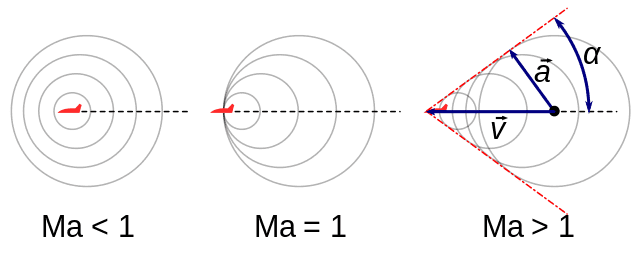

pload.wikimedia.org%2Fwikipedia%2Fcommons%2Fthumb%2F2%2F25%2FMach_cone.svg%2F640px-Mach_cone.svg.png
Yeah, I guess that was too strong of a statement.
I clarify it to mean that since sound moves at Mach1, and the shock is moving away at a speed of subsonic velocity M2 ( less than Mach 1) , then depending upon the angle α which is a function of velocity v of the object, the arc angle ( for the picture ) of the sound that will eventually encounter the shock will vary with the speed of the object. Sound at an angle great then that will be heard anytime by anyone within the cone, baring 1/r^2.
Make more sense now I hope.I just realized that the picture might be labeled incorrectly, Do they mean Ma is the velocity of the shock? Or something else?
Ma is always < 1. That is the normal velocity of the shock should be subsonic within the cone.

I was actually referring to the general case of a sound wave crossing a shock wave. In fact, it is the general consensus in this thread (except maybe for @fizzy ) that no sound waves emitted by the airplane will ever reach the front shock wave.
Ma is the Mach number of the moving object, which is the object velocity divided by the local speed of sound.
This is why I wrote post #27 where I made the distinction between pressure waves and sound waves. One is due to aerodynamics (the airplane pushing the air) and the other is from a sound source. The shock wave is caused by the pressure waves. It is possible to design an object that will NOT produce a shock wave (see post).
The Mach cone in your post is true for both pressure waves and sound waves. But it will correspond to a shock wave only in the case of pressure waves. In reality, it often look more of a bow shape than a cone shape (see bow shock), it depends on the shape of the object:
With sound waves only, there shouldn't be any shock waves.

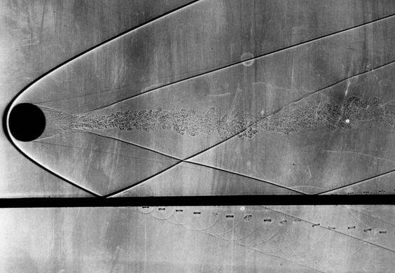

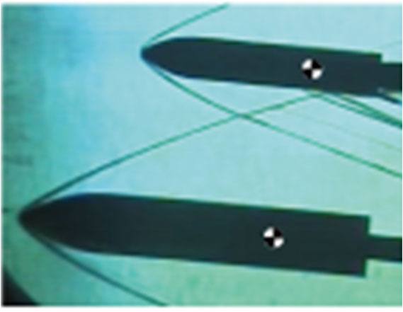

boneh3ad said:
When a sound wave interacts with a shock, it is very unlikely that it will come out the other side unchanged. Most likely the wave will undergo some degree of additional attenuation because shocks are highly dissipative. They wouldn't necessarily be completely destroyed, though.
To add to the above, see the below pictures of shock waves passing through each other, without canceling or dissipating. I see no reason why explosion shocks generated by a gun at the side wouldn't survive passing through the aerodynamic tail shock waves.
Source: http://stl-www.aero.kyushu-u.ac.jp/research/index_r_e.htm
Likes 256bits and mfb

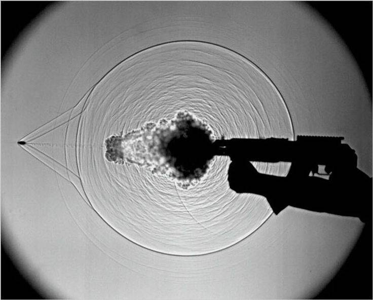

So the spherical shocks from the gun can continue to propagate forward, and reach a detector in reverse order of their generation.
Oh great, so we now go back about 3 days and start again.
Your shotgun photo is a static bang. The cannon ( or other on board sound source ) is also moving at mach2 and has its own bow wave and mach cone. The froward propagation is like that of the craft itself. This whole sound backwards thing comes from assuming these little spherical wave-fronts and this is not appropriate. The speed of sound depends upon the air pressure and density of the medium. This in NOT isotropic for sound emitted by a supersonic sound source.
This, rather old looking paper talks about stagnation temperatures of up to 11,000 F in missiles. Presumably up from an ambient of about 220 kelvin. That puts pressure up around 10 bar , it seems.
ntrs.nasa.gov/archive/nasa/casi.ntrs.nasa.gov/19930090162.pdf
Speed of sound more than doubles at 1500 F even at 1 bar.
http://www.engineeringtoolbox.com/air-speed-sound-d_603.html
The air closer to the nose cone gets progressively heated and pressurised and becomes more dense. This means that the speed of sound nearer to the cone is slightly higher than just a little further in front. Hence effect of sound energy 'piling up'.
Like I said several days ago, the reason that the sound in front of the craft is propagating at mach 2 is because that is THE SPEED OF SOUND at that point in the medium.

No one claimed (or even suggested) that sound would pass through the mach cone from the front of the aircraft. I don't know why you keep arguing about that point.
It does not matter if a source of sound is moving if the sound emission happens within a negligible time interval. There is no mach cone from a single explosion, it doesn't matter if the explosives are attached to the aircraft or explode directly next to the aircraft at any other speed.

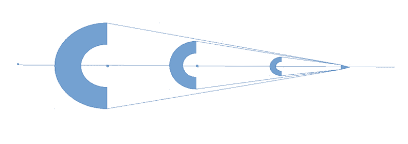

This is what I think the wave fronts should look like.
Backward propagation can probably be approximated as spherical with significant doppler shift. Forward propagation is at the speed of the aircraft so all forward waves are coincident.
Now I have put a straight line between the two which is clearly not accurate but gives an idea. I can't be bothered to make a research project out if this .
All depends upon correct calculation of that part. Immediately around the nose cone it will be the mach bow wave, and I suspect this is the case going out from there too.
If there is some space between the lines, as in my clumbsy hand drawn graphic, that would leave open the possibility for backwards sound. I'm NOT suggest that is the case with this graphic. I don't believe that is the case. But I don't think we can be more definative without doing some serious work, which would be interesting but I don't have the time to do.

A.T. said:
The front shock contentiously propagates at the speed of the aircraft, because it contentiously has the aircraft behind it compressing the air. A short explosion shock at the side has no such reason to propagate at the speed of the aircraft.
That's betting thinking. But the shock wave is not just directly in front. It is the mach cone. Everything inside the mach cone is going progressively more slowly as a non linear function of the ( normal? ) distance from the cone surface. The shock front will reduce to propagating at mach as we look further back along the cone.
Sound just inside the cone will be severely doppler shifted. Sound propagating perpendicular to the line of flight will not; and backwards will be doppler shifted to lower.
I still don't see much proof or demonstration of a reversed sound effect but it is not possible to be definitive on the basis of hand-waving thought exercises such as this thread.
