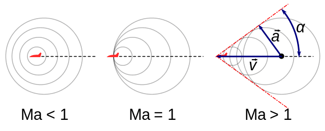

  • #45
russ_watters said:
How? At the very least, sounds trying to travel away from the plane forward will be overtaken and obliterated by the plane.
Imagine being right under the plane, already inside the cone, in the right picture:
russ_watters said:
And it is my understanding that the whole forward arc from the points tangent to the mach cone are part of the mach cone because they are emitted on the cone.
Why the whole forward arc? Only the parts emitted at 90deg - alpha form the cone.

[EDIT]
I've just seen A.T's comment #45
https://www.physicsforums.com/threads/can-we-hear-a-supersonic-plane.881162/page-3#post-5540053
This diagram puts the 'spherical' waves in their correct context. I do not see how anyone can conceive of hearing sounds in a reverse order. The older waves always arrive first.

  • #59
The diagram shows the exact opposite, of what you claim it shows: If the supersonic plane passes very close to the detector, the youngest signal (smallest circle, emitted most to the left) will reach the detector first. Thus the signals are detected in reverse of the emission order.
Maybe an animation can help you:
https://upload.wikimedia.org/wikipedia/commons/e/e4/Dopplereffectsourcemovingrightatmach1.4.gif

  • #62
Yes, thanks, this image does help see where the misunderstanding lies. The wavefronts are not spherical ripples propagating like ripples on a pond. This animation will produce no sonic boom, there is no shock wave. What you have here is the wake of boat, not a supersonic aeroplane.
All the those segments inside the cone and traveling forward do not exist. They are not left trailing the craft they are compressed into the shock wave in front of it. They are part of the Mach cone.Clearly the sound pressure wave in front of the aircraft is not propagating at 332 m/s, it is traveling at the speed of the aircraft ! Many commenters seem to think that the "speed of sound" is some universal constant.
These simplistic ripples do not exist like that when you have a hard physical object thrust through the air at mach 2. The speed of sound increases with pressure. Clearly the pressure just in front of the nose cone will not be one atmosphere !So, yes, the animation is helpful in showing just where the misconceptions arise. These kinds of simplistic representations are useful in describing superposition of small disturbances in a uniform medium but there are limitations to where they can be applied.

How would the bangs from the cannon propagate if not spherically?
Why not?

So it seems to me that this is a consequence of the source term Q(t) having a special distribution in the supersonic case.
Chapter 9.1 of the book seems highly relevant for that case, too.
