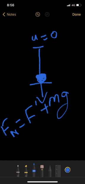

Thinking about the two forces on the knife while it cuts through the cardboard:
1) What is the direction of the knife's weight,W?
2) What is the direction of the resistive force on the knife, R?
3) What is the net (resultant) force acting on the knife in terms of W and R?
4) In your Post#1 calculation, which force did you find to be 5N?
Edit: typo's corrected.

1. Down
2. Up
3. F net = -W-5 =-2-5=-7
4. Force due to acceleration

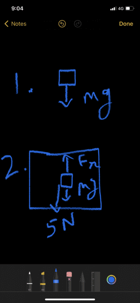

  • #43
bob012345 said:
There are two forces acting on the knife while it is cutting through the cardboard.
Yeah! -W and -5 N(due to acceleration).

The labels may be confusing. In part one you used the kinematics formula assuming to get an acceleration and using the known distance you got a=25 ##m/s^2 ##. You used that to get ##F=5N##. That ##F## was the net force acting down. The question is what is the friction force acting up?
  • #45
7 N
  • #46

  • #53
rudransh verma said:
I mean its obvious. There is a force on the surface and that is W.
As I use the term, "weight" (or "apparent weight") is the net inertial force resulting from gravity together with the choice of a particular rest frame.
My weight is a downward force on me. The force of my hand on a table is a separate force entirely. It is a contact force between my hand and the table.
When we "weigh" ourselves with a scale, we make use of Newton's second law. Since we are not accelerating, we can deduce that the supporting force from the scale (which the scale directly measures) matches the downward force from gravity (which the scale, thus, measures indirectly).
Yes! Frictional force ##{F_{fric}} = -(mg+force due to falling)= 7 N##.
The friction has nothing to do with falling. Calling it the force due to falling only adds confusion. It has to do with the kinetic energy the knife possesses as it hits the cardboard. That energy goes into ripping bonds as well as making heat and noise. In this case the kinetic energy comes about because the knife falls under the influence of gravity but the friction is not a force due to falling.
  • #59
In what direction does this mysterious 'force due to falling' act?
If it is in the opposite direction to mg, your equation gives:
##F_{fric} = -(0.20\times10-5) = 3N##, not ##7N##.
If it is in the same direction as mg, your equation gives:
##F_{fric} = -(0.20\times10+5) = -7N##, not ##7N##.
Anyway, the expression 'force due to falling' is meaningless and highly confusing in this situation. You need to avoid it if you hope to be able to solve other problems of this sort.
There are only 2 forces acting on th knife as it cuts through the cardboard:
knife's weight (W)
resistive force of cardboard (R)
And their vector sum is ##F_{net}##,
You need to work out how to answer the question using W, R and ##F_{net}##.
