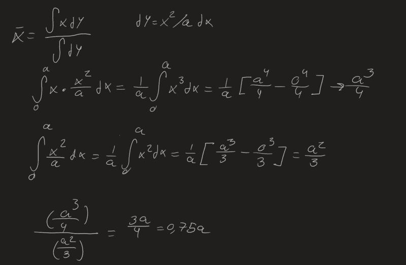

My solution (sorry for not writing it in LaTeX, I don't feel it's necessary since this try was more of a shot in the dark):
The answear should be (5/6)*a

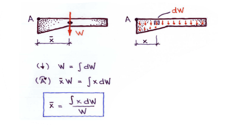

Had no idea of how to go about solving this, so tried using the followin equaiton (I have no idea what W stands for in this case, but it can be switched out for mass/volume/area):
Any suggestions about what could have gone wrong alternatively what I should do instead would be appreciated!
Thanks on beforehand:smile:
W could means weight.
Likes Heexit
This is a solid of revolution. It looks like you need to use $$\bar X=\frac{\int x~ dV}{\int dV}$$where ##dV## is the volume of a disk of thickness ##dx## and radius ##y##.

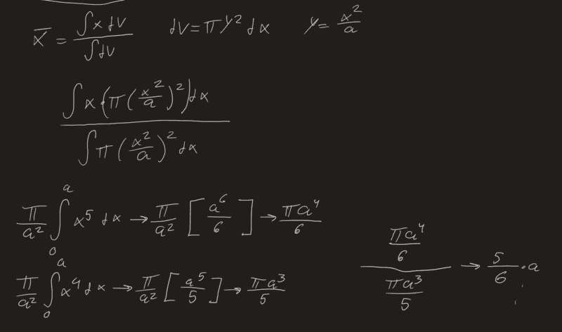

Thanks a lot for your help!
Here is my solution (still not in LaTeX!):
Looks OK even though not in LaTeX. Your letter ex in places looks a bit like the Greek letter alpha and that could be confusing.
Likes Heexit, berkeman and MatinSAR
