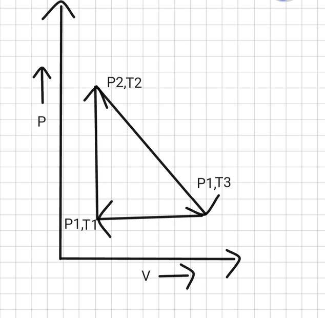

What is the change in heat and internal energy in this PV diagram (attached link) from T2 to T3 (T represents temperature)?
ΔQ=mC(T3-T1)
Δu=ΔQ + Δw
ΔQ=mC(T3-T1)
But, will this C be Cp or Cv. Both pressure and volume changes. So, neither of them can be.
Feeling so confused

Calculate the work from 2-3 which will be the area under the line from 2-3( trapezium area) and you know the change in internal energy= Cv(T2-T3) and u will get ∆Q

Note this is a full cycle. You start at point 1 and finish at point 1. So the system's final state is the same as its initial state. What can you say about the overall change in the system's internal energy, ΔU?
The area gives you the work done by the gas. ΔW:
https://www.ux1.eiu.edu/~cfadd/1150/14Thermo/Images/Diag10.gif
If you are dealing with n moles of an ideal gas you can use PV = nRT to get the value of V at each vertex and then derive a formula for ΔW in terms of the P's, T's, n and R.
Then you can find ΔQ.
Make sure the signs (+ or -) of your answers match the sign-convention you are using.

For an ideal gas, internal energy is a function only of temperature. By definition, Cv is given by $$mC_v=\left(\frac{\partial U}{\partial T}\right)_V$$But, since U is dependent only on T for an ideal gas, $$\Delta U=mC_v\Delta T$$
