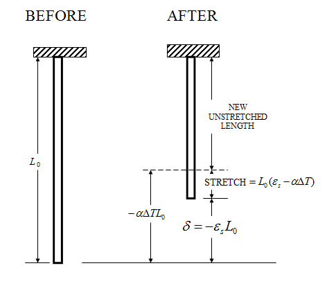

Chestermiller said:
No. The equation I gave is correct.
I refer to the question that i posted in post#1, the steel contracted,
original equation is
$$\sigma_s=E_s(\epsilon_s-\alpha_s \Delta T)$$
so, εs is negative(due to contraction) , and -σsΔT has positive value (-σs(-T) =positive) , so σs has positive value?
thus, leading the equation to become
σs=Es(-ϵs+αsΔT) ?
  • #37
$$\sigma_s=E_s(\epsilon_s-\alpha_s \Delta T)\$$
σs=Es(-ϵs+αsΔT) ?
You need to brush up on algebra.

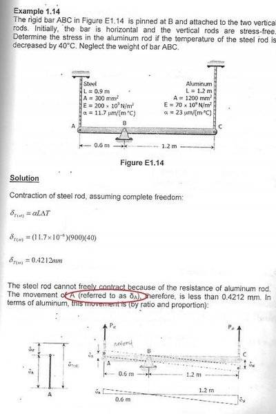

  • #39
haruspex said:
It's the contraction that would have occurred due to temperature if the aluminium rod were not there.
δA is the observed contraction in the steel. δst is the discrepancy
between the two.
But I do not understand what the diagram shows at C. It's a bit fuzzy, but it looks like it says the expansion of the aluminium rod
equals the observed contraction of the steel
rod. That is clearly not the case.
So, the change in length that we can notice is del (A) ? del (st) is the constraint?
  • #40
chetzread said:
Which part is wrong?
The equation as I wrote it is correct and the equation as you wrote it is incorrect. If ##\Delta T=0##, your equation predicts that ##\sigma=-E\epsilon##. Does that make sense to you?
  • #41
I would not have called it a constraint. That is not quite the right word. You could say the constraint is that the horizontal bar remains straight and attached to the two rods.
Del(st) is a consequence of that constraint. Another consequence is the stretching of the aluminium rod.
It might help to think of the process in three stages:
  1. The steel rod is cooled with no aluminium rod present. It contracts by δT(st). It is not under any tension or compression. Correspondingly, the horizontal bar rotates clockwise a bit.
  2. The aluminium rod is now to be attached to the bar, but because the bar has rotated it is not quite long enough. The bar is forcibly rotated back to the horizontal so that the aluminium rod can be attached. What has happened to the steel rod?
  3. The bar is now released. What will happen to the bar and each rod?
Likes Chestermiller

  • #45
Chestermiller said:
What if αsΔT\alpha_s\Delta T is negative, and ϵs\epsilon_s is also negative, but smaller in absolute magnitude than αsΔT\alpha_s\Delta T? Then, under these circumstances, ϵs>αsΔT\epsilon_s>\alpha_s\Delta T, and σ>0
Let ϵs = -3 , αsΔT = -6 , so
$$\sigma_s=E_s(\epsilon_s-\alpha_s \Delta T) = Es(-3-(-6) ) = +3 $$
so , we can rewrite the equation as $$\sigma_s=E_s(\-epsilon_s+\alpha_s \Delta T)$$ , am i right ?

  • #48

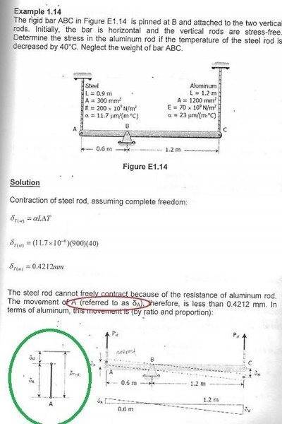

But , in the figure in post # 1 , we could see that $$\alpha_s\Delta T$$ > ϵs , this doesn't match with the equation that given by you
  • #58
How can you see that from the figure? It doesn't show these two quantities separately. Besides, which of the two equations gives tension for ##\sigma_s##, yours or mine? You yourself said that it has to be in tension.
Likes chetzread
  • #59
it 's not i said . It's in figure , refer to green circle

  • #63
In my judgment, the figure is incorrect.
Likes chetzread

  • #67
The diagram in the green circle matches what I wrote in post #4:
chetzread said:
the δT(st) is contraction of steel rod due to drop in temperature.
haruspex said:
it's the contraction that would occur due to the temperature change alone, yes. δA is the observed contraction in the steel. δst is the discrepancy between the two.
But as I also noted, the main diagram is very hard to read at bottom right. It shows some other δsome subscript for the extension of the aluminium rod. What is the subscript there? If that is also just "A" then it is wrong. Alternatively, if δA is defined as the extension in the aluminium rod then the diagram in the green circle is wrong.

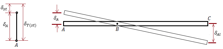

Is the labeling as follows?
##\delta_{st}## is the change in length of the steel rod "due to stress alone".
##\delta_{T(st)}## is the change in length of the steel rod "due to temperature change alone".
##\delta_A## is the net displacement of point A (also the net change in length of the steel rod).
##\delta_{Al}## is the change in length of the aluminum rod due to stress (also the displacement of C).
Likes chetzread

Yes, but ##\delta_st## is due to stress? Why there's stress? What caused it?
