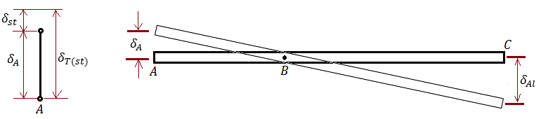

TSny said:
δstδst\delta_{st} is the change in length of the steel rod "due to stress alone".
What forces will cause the stress?
  • #72
TSny said:
Is the labeling as follows?
##\delta_{st}## is the change in length of the steel rod "due to stress alone".
##\delta_{T(st)}## is the change in length of the steel rod "due to temperature change alone".
##\delta_A## is the net displacement of point A (also the net change in length of the steel rod).
##\delta_{Al}## is the change in length of the aluminum rod due to stress (also the displacement of C).
that's exactly same in the notes
the change in length that we will notice is ∂ A , am i right? why we wouldn't be able to see ∂ A + ∂ (st ) = ∂ (Tst) ?

I told you twice that I could not read the subscript on the δ at C. If you had told me earlier it said δAl that would have been a great help.
You agreed earlier that both rods are stretched under tension because otherwise they would not be long enough for both to reach the rigid bar.

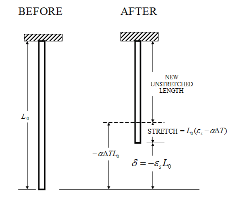

Here is the figure I was referring to:
It is a before and after picture of the steel bar. After cooling, the new unextended length of the steel bar is now equal to ##L_0(1+\alpha \Delta T)##. This would be the new length of the bar if it were not under stress, and is shorter than the original length because ##\Delta T## is negative. The actual new length of the bar is equal to ##L_0-\delta=L_0(1+\epsilon_s)##. The amount of stretching that at bar has experienced relative to its new unextended length is
$$(L_0-\delta)-L_0(1+\alpha \Delta T)=L_0(\epsilon_s-\alpha \Delta T)$$Thus, the effective strain in the bar which gives rise to tensile stress is ##\epsilon_s-\alpha \Delta T##, and the tensile stress in the bar is given by: ##\sigma=E(\epsilon_s-\alpha \Delta T)##
Likes chetzread
  • #79
\Delta T##, and the tensile stress in the bar is given by: ##\sigma=\epsilon_s-\alpha \Delta T##
So, what you are saying is without the constrain(aluminum rod), the steel rod will contract to the unstretched length... But,
there's aluminum rod to prevent the steel rod to
contact too much.
So what we notice is delta only?
##\delta_{T(st)}## is not observable because ##\delta_{T(st)}## represents how much the length of the rod would change due to cooling if the rod were not constrained by the rest of the system. But the constraint keeps the rod from actually changing by ##\delta_{T(st)}##. So you never observe ##\delta_{T(st)}##.

Here is a thought experiment for you. You take a rod of steel and cool it (without constraining it) so that it contracts to a new length. The stress in the rod after cooling is still zero, but it has experienced a negative strain. Now you stretch the rod at constant temperature back to nearly (but not quite) its original length. Is it now under tension or compression?
so , by referring to post #1 ,

No. ##\epsilon_s## has a negative value, but -αsΔT is positive and exceeds this negative value, so the net effect is that σs = positive.

Contraction is just negative expansion. If ##\Delta T## is negative, and, if the rod were free to contract, ##\epsilon_s## would be negative, and equal to ##\alpha \Delta T##, and the stress would be zero. But, ##\Delta T## were negative, and, if the rod were partially constrained from contracting, ##\epsilon_s## could still be negative, but, relative to the new unextended length of the rod, there would be extension, and the stress would be positive.

haruspex said:
It's the contraction that would have occurred due to temperature if the aluminium rod were not there.
δA is the observed contraction in the steel. δst is the discrepancy between the two.
But I do not understand what the diagram shows at C. It's a bit fuzzy, but it looks like it says the expansion of the aluminium rod equals the observed contraction of the steel rod. That is clearly not the case.
here's the full notes , δst is caused by force Pst( in upward) ?
if it' so , we will be able to 'see' the δst , am i right ?
  • #98
It is caused by the force and the temperature change. The force on the rod is in the upward direction at the top of the rod and in the downward direction at the bottom of the rod. The force on the lever is in the upward direction at the connection with the steel rod.
δst is defined as the displacement that you see.
  • #99
The force at point A is pointed upwards or downwrads?
  • #100
Well, you tell me. What is the direction of the force that the rod applies to the lever at point A? What is the direction of the force that the lever applies to the rod at point A?
Likes chetzread
  • #101
Upwards?
If it's upwards the change in length that we can see with naked eyes is del (st) + del (a), rather than del (a) only, right?
  • #102
chetzread said:
Upwards?
I asked you two separate questions. What are your answers to each of these questions?
Likes chetzread
  • #103
The force that the rod applies to lever is upwards, the force that lever applies to rod at A is downwards?
  • #104
It sounds like you're not sure. Please let me know when you are sure.
  • #105
Huh? If the forces opposite to each other, they will cancel each other, right? If so, the force P(st) wouldn't exist, right?
