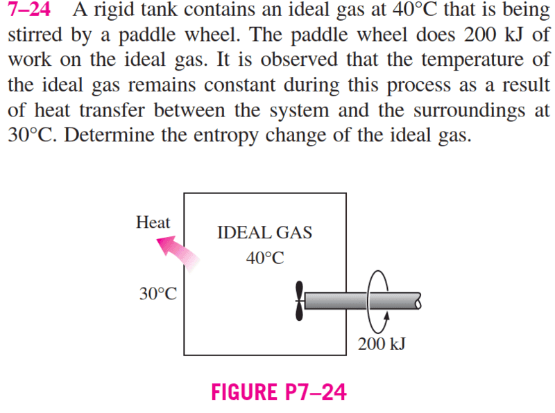

Q: What are the differences between the heat transfer calculated by the energy conservation equation and the heat transfer determined by the Gibbs relation? ##why\ \left( ans\_1 \right) \ne \left( ans\_2 \right) ##
reference
Energy balance:
Q_{in,net}-W_{out,net}=\cancel{\bigtriangleup U_{cv}}\cdots \left( 1 \right)
Q_{in,net}=-Q
W_{out,net}=-W_{in}
\therefore \left( 1 \right) =-Q+W_{in}=0
\therefore Q=W_{in}=200KJ\cdots \cdots \left( ans\_1 \right)
entropy balance equation.
entropy definition formula.
Gibbs relation.
dS_{sys}=\left( \frac{\delta Q}{T_k} \right) _{int.rev}\cdots \left( 2 \right)
\bigtriangleup S_{sys}=m\left( \frac{\cancel{du}+p\cancel{dv}}{T_k} \right) =0
\therefore \left( 2 \right) =0
\therefore Q=0KJ\cdots \cdots \left( ans\_2 \right)

The entropy change of the system is zero since the gas temperature and volume are constant. The entropy transferred from the system to the surroundings is ##200/(30 + 273)=0.660\ kJ/K##. From the Clausius relationship, $$\Delta S=\frac{Q}{T_{surr}}+\sigma$$where ##\sigma## is the amount of entropy generated within the system during the process. So, $$0=-0.660+\sigma$$and the amount of generated entropy is equal to 0.660 kJ/K.
This question is a little ambiguous since, if the system is at 40 C and the surroundings are at 30 C, the system should be transferring heat to the surroundings until it too is at 30 C. But its final temperature is stated to be 40 C. It isn't clear what one should take as the temperature at the interface between the system and surroundings when the heat transfer Q and entropy transfer ##Q/T_{interface}##is occurring.

You've provided a detailed explanation, thank you. I finally understand.
