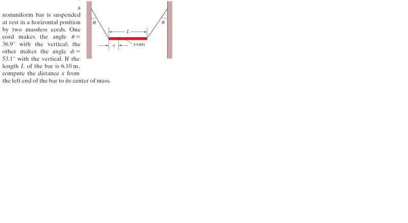

I can get the answer to this problem, but...
torque and force equilibrium
If I choose my axis of rotation for torque analysis to be the left-end of the plank, I can get the correct results.
If I instead choose the com point -- I run into a dead end. Is there a way of a priori knowing this would happen? Thank you.

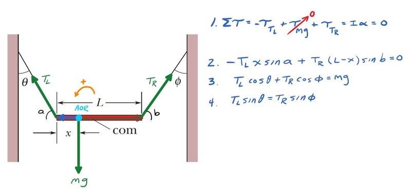

Here's my work based on using the COM as my axis of rotation. It seems I can't solve for x this way?
You introduce angles ##a## and ##b## and now have too many unknowns ? Is that what you mean ?
I can find angle a and angle b. Despite this it seems I still can't find x from equations 2, 3 and 4.
Ok, so you have three equations with three unknowns, so what is going wrong ?
I think there are 4 unknowns: Tr, Tl, m and x.
Do you need to know m to find x?
(Tr/m), (Tl/m), and x are the unknowns.
Ah, yes - I see. Thank you so much for your help!
