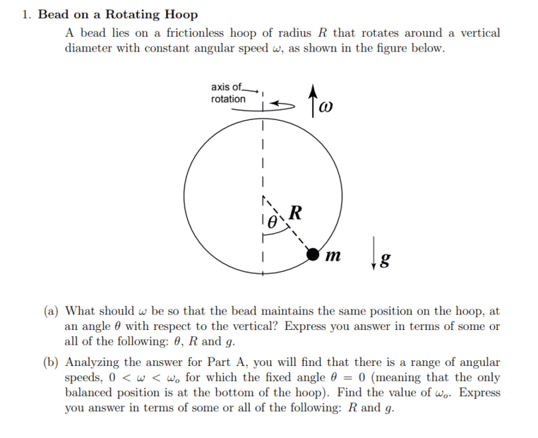

A bead lies on a frictionless hoop of radius R that rotates around a vertical
diameter with constant angular speed ω, as shown in the figure below.
(a) What should ω be so that the bead maintains the same position on the hoop, at
an angle θ with respect to the vertical? Express you answer in terms of some or
all of the following: θ, R and g.
(b) Analyzing the answer for Part A, you will find that there is a range of angular
speeds, 0 < ω < ωo for which the fixed angle θ = 0 (meaning that the only
balanced position is at the bottom of the hoop). Find the value of ωo. Express
you answer in terms of some or all of the following: R and g.

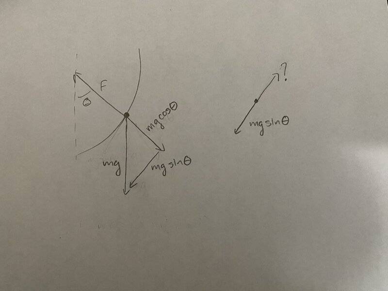

a_r=-rω^2 (I'm not sure if it's relevant but I think it is.)
For whatever reason, I'm having a hard time conceptualizing this problem. I understand that the tangential components of all forces involved need to cancel out in order for the bead to be stationary. I also understand that there is a mgsinθ in the negative θ-hat direction. What I don't understand is to find the force opposite of it.
The bead is not stationary when ##\theta## is constant. Can you describe its motion?
What can you say about the net force for such motion?
The bead is rotating around the axis that the hoop is rotating around, which means that there is inward Force toward the center of the hoop. I believe the Force would be characterized by F=ma_r=m(-rω^2) since there is no acceleration on ω thus there is no a_θ component.
If that is right, where I'm getting stuck is how do I use this inward Force to figure out the tangential component of this Force along the hoop itself to find the net zero?

Show us your free body diagram of the bead please.
I believe the Force inward would be characterized by F=ma_r=m(-rω^2).
The trajectory (for a bead which remains at a fixed angle ##\theta##) is circular and has radius r. So yes, the net force on the bead would be inward with magnitude ##m\omega^2 r##.
Edit: However, as @Steve4Physics makes clear, we should be wary -- what is ##r##?
But let us look at your free body diagram. You have the force of gravity downward. You've split this into components for some reason and drawn both the gravitational force vector and its two component vectors. You've also drawn a force labelled "F". What is that?
Presumably you mean that ##F## is the normal force of the wire on the bead. It would be nice if we knew the magnitude of ##F##. There is a way to get that.
(Sorry, @AzimD, looked at the text first and the drawing second)
jbriggs444 said:
The trajectory (for a bead which remains at a fixed angle ##\theta##) is circular and has radius r. So yes, the net force on the bead would be inward with magnitude ##m\omega^2##.
But you've been asked for a free body diagram.
I provided it with the picture!

The bead is moving in a horizontal circle.:
Is the centre of this circle the centre of the hoop?
What can you say about the direction of the net force on the bead?
By the way, you should state what force 'F' represents in your FBD.
If, by F in your equation, you mean the force F in your figure, then your equation is incorrect. What is the direction of the net force vector on the bead, (a) horizontal, (b) vertical, or (c) in some other direction? What is the vertical component of the normal force vector N of the wire on the bead (in terms of the magnitude N)? What is the horizontal component of the normal force vector N of the wire on the bead (in terms of the magnitude N)?
What is your parameter r expressed in terms of the parameter R in the original figure?

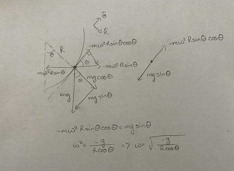

Okay so after reading all of the replies, I think I understand it a bit better. The acceleration isn't directed towards the center of the hoop but rather the axis itself, since that's what the bead is rotating about.
I think I did it correctly for the most part, except I know that my signage is wrong. There should not be a negative in the result of ω. That being said, is the acceleration not directed inward?
I've attached my work to this!

Your FBD is missing a force.
You haven’t answered my questions in post #13
Since this question, I realized the force in my FBD towards the center of the hoop was incorrect and rather it should be into the axis. The Net Force Vector would be in some other direction correct? Particularly in the direction tangential to the hoop itself?
I'm not entirely sure about the Normal Force in this question. Does it matter though given that it's dealing with ω and I really just need to find the Force Component acting opposite of mgsinθ to figure out ω?
Is the missing force the Normal force? @Chestermiller made a mention of this force, I don't see how to fit it in, also I don't see how it's relevant.
If so, would the Normal Force be directed toward the center of the Hoop as it rotates?
Edit: Yes the r is R, I fixed that in the next FBD.
The net force is horizontal, perpendicular to the axis. The normal force is directed toward the center of the hoop .
Since you are only concerned with the tangential force balance, it is not relevant, but you really should show it.
The mistake, though, is that you have treated the centripetal force as an applied force balancing the tangential component of gravity. That has led to a spurious minus sign. Centripetal force is that component of the resultant force which acts perpendicularly to the velocity.

I disagree. In my judgment, the normal force is very relevant.
The vertical component of the normal force is ##N\cos{\theta}## and the horizontal component is ##N\sin{\theta}##. So the force balances on the bead in the vertical and horizontal directions read:$$N\cos{\theta}=mg$$and $$N\sin{\theta}=m\omega^2r=m\omega^2(R\sin{\theta})$$What do you get if you eliminate N between these two equations?
The realization that the net force on the bead is horizontal provides a very compelling reason to express the force balance in the horizontal and vertical directions, rather than the normal and tangential directions. The resolution of the gravitational force into the tangential and normal directions as the OP did is just a waste of time and effort in my judgment.
It has no component tangential to the hoop. If the force balance equation in that direction is all that is needed to solve the problem then it can be made irrelevant.
I finally see what you are saying. Dotting the vector force balance by a unit vector in the tangential direction eliminates the contribution of the normal force and immediately gives you the desired relationship.

AzimD said:
I was always under the impression that the Centripetal force is an inward force.
It is inward, but something has to supply it.
If you whirl a mass around on the end of a string then the only forces acting on it are gravity and the tension in the string. The resultant of those is called the centripetal force. It is not an additional force.
More generally, if a body has velocity ##\vec v## and acceleration ##\vec a##, its centripetal acceleration is defined to be the component of ##\vec a## normal to ##\vec v##. The net force on the body is ##m\vec a##, and the component of that normal to ##\vec v## is defined to be the centripetal force.
However, if you use the reference frame of the body then there is, by definition, no net acceleration. To balance the forces experienced, one has to introduce the "fictional" centrifugal force. This is an applied force, not a resultant.
In terms of unit vectors, the force balance reads: $$N(\cos{\theta}\mathbf{i_z}-\sin{\theta}\mathbf{i_r})-mg\mathbf{i_z}=-m\omega^2R\sin{\theta}\mathbf{i_r}$$
The unit tangent vector to the ring is $$\boldsymbol{\tau}=\cos{\theta}\mathbf{i_r}+\sin{\theta}\mathbf{i_z}$$
What do you get for the dot-product of the unit tangent with the force balance?
