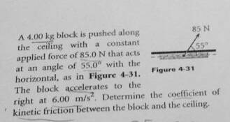

A 4.00kg block is pushed along the ceiling with a constant applied force of 85.0N that acts at an angle of 55.0 degrees with the horizontal. The block accelerates to the right at 6.00 m/s^2. Determine the coefficient of kinetic friction between the block and ceiling.

@SammyS Here's the question

Could you produce a free body diagram for the block alone?
