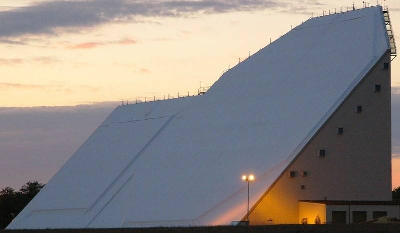

Knowing DSN can pick up the 22 W transmitter of Voyager 1 at 1.8 light-days, means that everything else being equal you would need around 16 MW of transmitter power at 4.25 light-year for DSN to also pick up that up such signal. And that is just using RF technology; I would expect using an accurately pointed laser to transmit to a space telescope near earth, or something similar, would require far less power still.
Likes Devin-M
For comparison I found Arecibo's transmitter (305m diameter) was roughly 1MW, and the most powerful radar on Earth (Eglin AFB Site C-6) is currently around 32MW...
https://en.wikipedia.org/wiki/Eglin_AFB_Site_C-6
https://www.hou.usra.edu/meetings/apophis2020/pdf/2013.pdf
