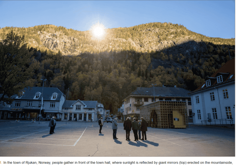

This sounds similar in concept (but not similar scale) to whole towns in Norway and France that use mirrors to provide sunlight.
https://www.theatlantic.com/photo/2013/10/using-giant-mirrors-to-light-up-dark-valleys/100613/

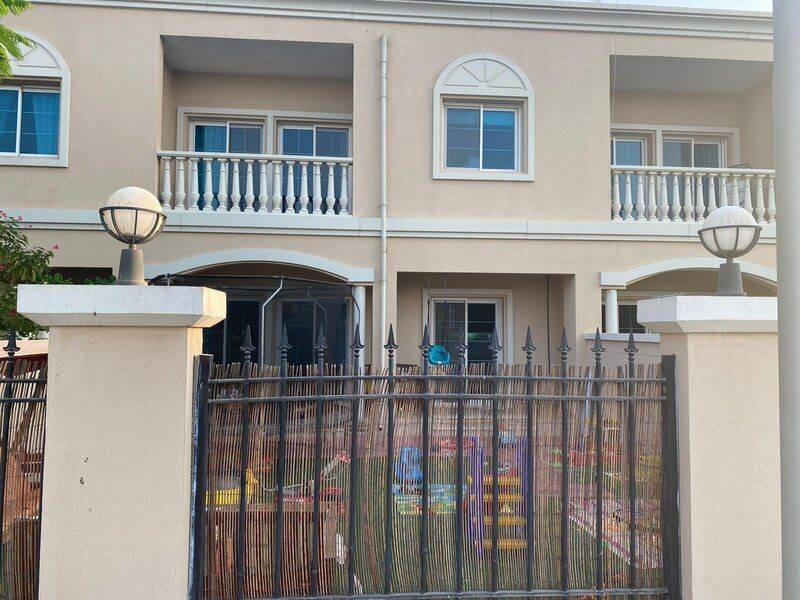

Here is a photo of the garden and the house, showing the doors as well as the pillars on which I plan to put the mirrors on a swivel.
Thoughts? Shall I go drop the convex mirrors and focus on regular ones? And for the size, the reflection is always as big as the mirror itself, right?
Lastly, for the heat reflection, if we go with regular mirrors, would the heat reflected to the house be more than that of the direct sunlight (like the other houses in the neighborhood that actually face the sunlight)?
Did I misunderstand anything? Thanks again!

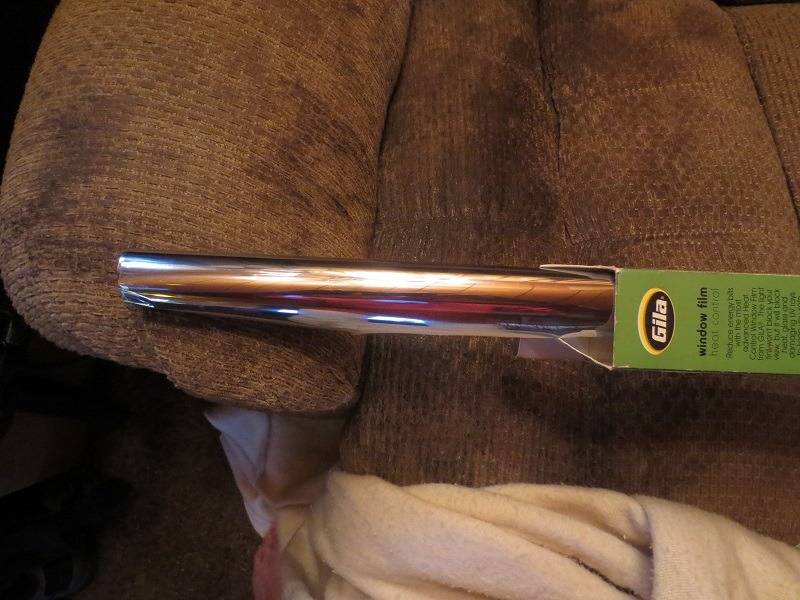

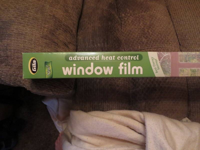

One more thing @Baluncore , you mentioned that rear silvered mirrors or ones with selective coating would reflect light but not the heat. I tried googling that a bit but could not find more information. Can you please provide more info about those mirrors?
For every mirror, the reflected amount of light is proportional to its shadow. What convex mirror does is, to spread that light wider => since it illuminates wider area, it'll be weaker on a certain spot. On the other hand, the mirror won't have to follow the sun to have some light reflected to a certain spot.
Flat mirror will illuminate a certain spot/direction for only a limited time, but for that time that spot of light will be intensive.
You might look at what coatings are used on window glass where you are.
I assume you want to block reflection of IR and UV, so only visible light remains. If the light will enter the house through windows then that may have been done. If through an open door then a coated mirror might make a difference.

  • #48
Here's something you might want to consider:
edit: I'm thinking, attaching to a thin (maybe 1/4 inch) curved sheet of plywood.
  • #49
Since I haven't gotten any response to this, I'm assuming it's not that good of an idea.
  • #50
What's the stuff supposed to do ? Alu foil reflects a lot better I would expect ...
