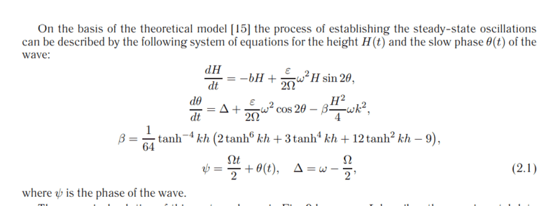

Please help me understand the relation of the critical frequency with the resonant frequency of Faraday waves to exist in a container filled with liquid like water. How can we calculate it mathematically?
IF I want to investigate it by changing the viscosity, depth of the liquid and temperature and how it affects the amplitude and critical frequency of the Faraday waves, if there is no mathematical equation, can we deduce one? can there be a relationship? and also can anyone suggest more relations or investigations I can take with faraday waves?
I am little confused with existing literature and the physics of faraday waves, especially the mathematics of it if it exists. Please help me. This is my current research question
"How do variations in the viscosity of the liquid (or different liquids) and changes in the temperature of the vessel affect the wavelength, amplitude, and frequency of Faraday waves?"
Is it valid? IF yes can you help me with the methodology part and physics and mathematics part of it? what is the maths I can use or formulas to calculate? Is water propagation and dispersion relevant? Can this science be used- https://en.wikipedia.org/wiki/Dispe...e table below, the,the phase and group speeds.

No, I am in grade 12th doing IB Diploma program and this is my investigation for my Extended Essay(EE) which is 4000 word research paper. Can you please guide me on how I can go with this topic and investigation? I am facing difficulty with comprehending research papers and mostly their mathematics. So, Guide on the mathematics and investigation would be of immense help to me. Thank you

Also, on schoolwork projects like this, we require that you show your own work first before we can offer tutorial help to you. Also, asking us to read through your multiple PDF references and describe the subject to you is a pretty big ask.
How did you pick this project? What parts of the math to you understand so far? How much calculus have you studied so far in school?

I understand every branch of mathematics except in-depth calculus, I can solve differential equations but don't know integration and all. But I am studying that now so I can use it for my investigation, also I attached those papers as I thought it would be helpful for someone to go through maybe one and give me advice.
I tried to read the papers, I understood the theory but cannot understand the critical frequency aspect of it, shall I do the trial and error method to get one critical frequency, or is there any way to find it mathematically and then check it experimentally? Attached here is one equation used in the change in viscosity in amplitude, and it show this equation , can you explain me or share some resources to understand the maths?

Can you review by current investigation question? how shall I approach it?
