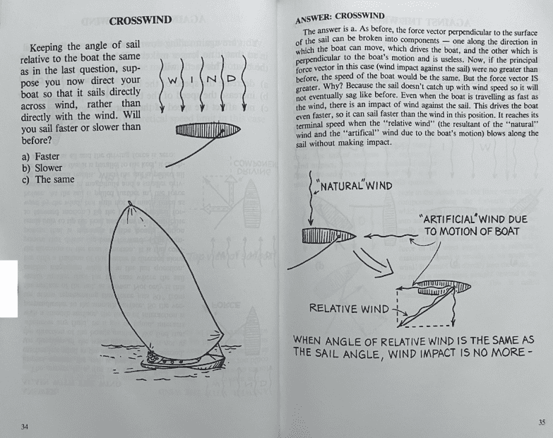

Hi everyone,
I was looking to develop my physical insight when I encountered this book by Lewis Caroll Epstein. For the crosswind problem, I couldn't understand the author's explanation; in particular, his concept of "artificial wind," and the force being larger in this case than the previous one. I understand that the sail will sag when the speed of the boat in the direction of normal to the sail is equal to that of wind in the same direction. I have attached the relevant pages of the book below.

In the previous one, the boat is sailing vertically in the same direction as the wind.
What is your question?
How is the sail oriented (as in the previous question)?

Relative to the boat, the sail is oriented the same way in this and the previous question.
One would think that the answer then, is that the boat sails at the same speed in both cases but that is not what the author says. I'm trying to understand why this is so. More details are in the original post.

When the boat is sailing with the wind directly behind it ('previous case'), the force depends on the excess of the wind speed over the boat's speed. As the boat speed increases, that excess reduces so the force reduces. When the two speeds match, that excess is zero, so there is no wind force on the sail and it sags. From the point of view of the sail, there is no wind.
When sailing across the wind (case of the diagram above), the sail will get a force from the wind as long as the wind is hitting the inside of the sail (the port side in the diagram), not the outside (starboard side), and not directly in line with the sail. That force will have direction perpendicular to the direction of the wind relative to the sail, pointing outwards to starboard in the diagram.
We then decompose that force into one perpendicular to the boat's direction, which is offset by the keel (so it doesn't affect the boat's motion), and one parallel to the direction, that pushes the boat forward.
So in this case, the force doesn't go to zero until the relative wind is blowing in line with the sail. The sail looks to be at an angle of about 30 degrees to the diagram's horizontal, so that will happen when the boat speed equals the wind speed divided by tan(30 degrees), which equals boat speed times about 1.73. So unlike the with-the-wind case, the boat can go up to 1.73 times wind speed before losing its wind propulsion. Whether the boat can actually reach that speed will depend on other things like the boat's sail size and drag in the water.
"Artificial wind" means the component of the windspeed relative to the sail, that arises from the boat's motion relative to the water. Think about riding a bike. If there's no wind, as soon as you start, you have a headwind. The faster you go, the stronger the headwind. That's all 'artificial wind'. The wind perceived by the rider - the 'relative wind' is a combination of the actual wind (wind speed relative to ground) and artificial wind (rider speed relative to ground). The combination is a 'vector sum'.
If there's a sidewind, perpendicular to the direction you will ride, the artificial wind starts at zero and increases speed as you speed up, making the relative wind swing from the side towards the front, getting closer to the front the faster you go
The force on the sail depends on the relative airflow (apparent wind)
When you sail directly downwind that relative airflow is going to zero, as you approach windspeed.
When you sail perpendicular across the wind, the downwind comportment of the relative airflow (vertical in the book) stays constant, while the induced component (horizontal in the book) increases with your speed. So the total relative airflow increases.
In the book the sail is fixed, so the speed is limited by the fact that the relative airflow also changes direction. But in reality you can set the sail freely so the speed perpendicular across the wind is limited only by the efficiency of the boat. It can be much higher than the windspeed relative to the ground.

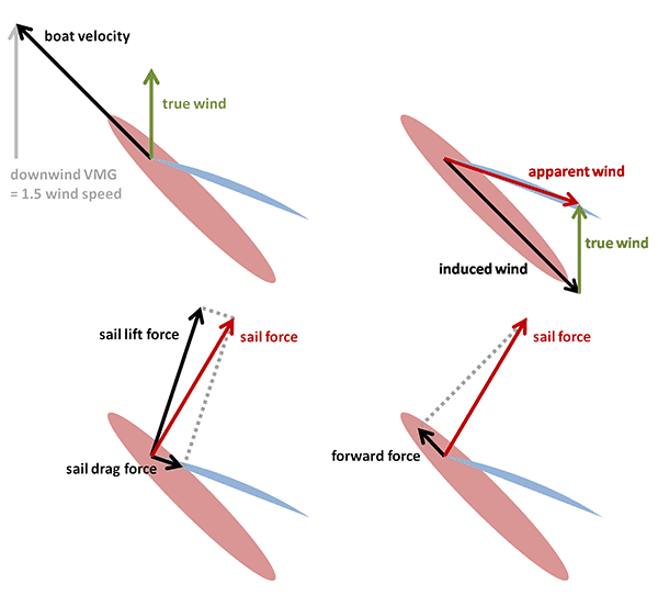

You can even outrun the moving airmass along the downwind direction:

Yes, but this is a very non-technical book for laymen. Lift (L) and drag (D) is one possible to decompose the resultant force (R). Normal (N) and axial force (A) is another:
Source: https://www.aerospaceweb.org/question/aerodynamics/q0194.shtml
The simple argument in the book is that when sailing across-wind at windspeed or even faster, you can still have N pointing in the right direction that propels the boat, while this is not possible when sailing directly downwind.

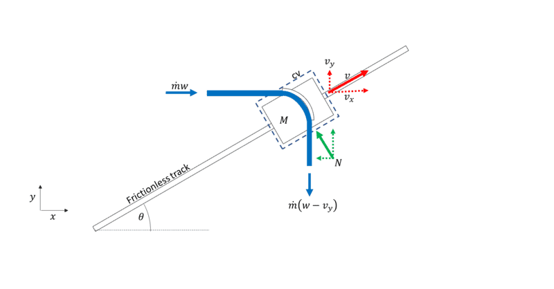

I can't arrive at that. Imagine a cart on a frictionless track moving in a horizontal plane (top view) inclined at some angle ##\theta##, and a ##90^{\circ}## vane (sail).

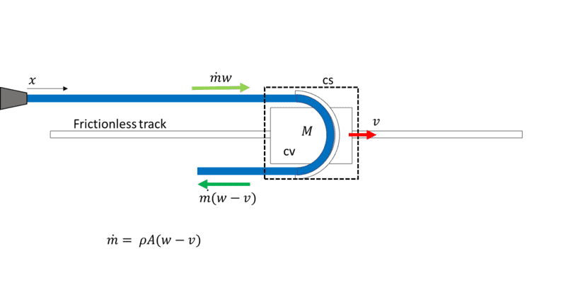

Begin by applying the "Momentum Equation" for flow with constant cross-sectional properties:
$$ \sum F = \frac{d}{dt} \int_{cv} \rho v ~d V\llap{-} + \sum_{cs} \dot m_o v_o - \sum_{cs} \dot m_i v_i $$
##cv## is the control volume
##cs## is the control surface - dashed box
the subscripts ##o,i##on the momentum terms refer to the outflow, inflow respectively.
This becomes two equations in the direction ##x,y##:
Force
$$ \sum F_x = -N \sin \theta $$
Accumulation
$$ \frac{d}{dt}\int_{cv} \rho v ~d V\llap{-} = \frac{d}{dt} \left( v_x\int_{cv} \rho ~ d V\llap{-}\right) = M\frac{d}{dt}( v_x )$$
##M## is the total mass of the control volume ( cart + flow ) and it is constant assuming incompressible flow (continuity)
Momentum
$$ \sum_{cs} \dot m_o v_o - \sum_{cs} \dot m_i v_i = \dot m_{o_x} v_x - \dot m_{i_x} w $$
under continuity ##\dot m_{o_x} = \dot m_{i_x} = \dot m##
and w.r.t. the inertial frame the flow momentum outflow is non-zero ##\dot m v_{x}## ( the flow is following the cart in the ##x## direction).
Putting it all together for the ##x##direction:
$$ -N \sin \theta = M \frac{d v_x}{dt} + \dot m v_x - \dot m w \tag{1}$$
Repeat for the ##y## direction ( final result shown):
$$ N \cos \theta = M \frac{dv_y}{dt} - \dot m ( w - v_y ) \tag{2}$$
The objective is to solve the resulting system of linear first order ODE's by substitution using the track constraint:
$$\frac{v_y}{v_x} = \tan \theta \tag{3} $$
$$(3) \implies \frac{d v_y}{dt} = \frac{d v_x}{dt} \tan \theta \tag{4} $$
I solved (2) for ##N## and sub into (1), then sub (3) and (4) ( eleminating ##v_y## and its derivative) to get the following ODE:
$$ M \frac{d v_x}{dt} ( 1 + \tan^2 \theta ) + \dot m ( 1 + \tan \theta ) ( v_x - w) = 0 \tag{5}$$

The conclusion of all this is in the limit as ##t \to \infty## the RHS ##\to 0##, hence:
$$ \lim_{t \to \infty} u_f = 0 \implies \dot m ( 1 + \tan \theta ) ( v_x - w ) = 0 $$
In other words ##v_x \to w## as ##t \to \infty##.
We don't have to find a solution to (5), just observe the steady state response:$$ \cancel{ M \frac{d v_x}{dt} ( 1 + \tan^2 \theta )}^0 + \dot m ( 1 + \tan^2 \theta )v_x - \dot m w ( 1+ \tan \theta) = 0 \tag{6} $$
$$ \lim_{\frac{dv_x}{dt} \to 0} \implies v_x \to w\frac{1 + \tan \theta}{1 + \tan^2 \theta} \tag{7}$$
the limits of (7) in terms of ##\theta##:
$$\theta \to 0 , v_x \to w$$
$$ \theta \to 90^{\circ} , v_x \to 0 $$
So, as far as I can see it's never going to outrun the wind ##w## in the direction of the wind.
##v##(the magnitude of the cart velocity) is given by:
$$v = \frac{w ( 1 + \tan \theta)}{ \cos \theta (1 + \tan^2 \theta)} \tag{8}$$
Where have I blundered that allows the cart to go faster than the wind in the direction of the wind?

Not sure, but my quick guess is right at the start with the assumptions about the sail.
- Is the orientation of the sail fixed? Because the way it is drawn is good for intial acceleration but wrong for going with Vx > W, when the relative wind comes from north-east in your picture.
- Diverting the air by 90° corresponds to a lift/drag ratio of 1 at best, which is horribly inefficient.
The vectors for the situation look like below:

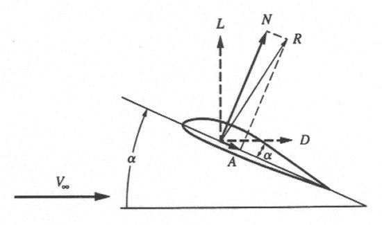

This thing about "lift". Where does that come from. The sail is a sheet of canvas?
Doesn't really matter. Even canvas sails can achieve a lift/drag ~= 5 as shown in my diagram. Rigid wing sails can do much better.
But the backside has roughly the same shape as an airfoil.
Note that some modern racing sailboats have rigid sails. So the idea of putting up an airplane wing in place of the mast and cloth sails is not crazy. In the picture below, it looks like they took an entire airplane.

You don't really outrun the airmass in the sense of leaving it behind, because you stay embedded in it.
erobz said:
I suppose lift is the hidden variable here ...
The key is rather that you have contact with two objects (like air and water) which are moving relative to each other. The concept works beyond lift and fluids.
erobz said:
... it’s not 100% relying on changing the momentum of the air impacting the sail…
Regarding this part: It is 100% relying on changing the momentum of the air. There is no magic here and even the simplest model with individual particles hitting the sail (very low density gas) can explain how it works:
This is all very nice animation but it’s severely lacking any mathematical rigor. In the cartoon, Wiley coyote runs in mid air chasing the Roadrunner…until he realizes it.
What is the maximum velocity of the cart in the following image?
The proof that it works is neither the animation nor math, but racing boats which do it for years (ice boats for a century). The animation just shows how trivial it is.
Same as for a boat with a fixed sail going directly downwind. But the boats that achieve downwind components greater than windspeed are not going directly downwind. Your original model was more relevant, just your sail model was bad.
Mathematical rigor is useless, if in order to formulate / solve your math, you have to make assumptions which completely change the scenario. I recommend using vectors in this case (see post #21).
Likes hutchphd
  • #33
A.T. said:
Same as for a boat with a fixed sail going directly downwind. But the boats that achieve downwind components greater than windspeed are not going directly downwind. You original model was more relevant, just your sail model was bad.
I was trying to simplify in order to discuss maximum possible impulse.
There is no "real" sail that can completely reverse the momentum of the incoming flow, as shown in #29. It is the theoretical maximum possible impulse that can be applied to the boat in the direction of motion. There is no possible alteration of a vane which could impart any greater momentum to the cart in the ##x## direction than what is shown in #29. For the ##x## component of velocity ##w## is a hard limit. I've shown it with Newtons laws, Eulers, and Reynolds laws twice now for two independent vane configurations.
Real wind gusts, swirls, changes direction., any "true" measurement of downwind speed greater than the wind is going to be obscured by this reality. Conservation of Momentum is not.
  • #34
erobz said:
I've shown it with Newtons laws, Eulers, and Reynolds laws twice now for two independent sail configurations.
But neither one of your configurations corresponds to a boat with downwind component greater than windspeed.
Go back to your first one, but rotate the sail by 90° clockwise. What happens when Vx = W? Can you still accelerate?
  • #35
No it can not accelerate. The mass flowrate ##\dot m = \rho A (w-v_x)## entering the control volume always goes to ##0## as ##v_x \to w##. The fluid jet can only just keep up with the cart, it can no longer impart any further momentum to it. If your hope was that the momentum outflow changes to ##\dot m (v_y +w)##, sorry ##\dot m \to 0 ##.
