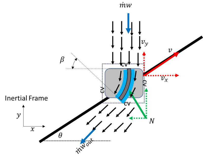

Look at the diagram. It shows everything I have planned.
This equation represents Newtons Second in Fluid Mechanics under the assumption of constant cross-sectional properties:
$$ \sum F = \frac{d}{dt} \int_{cv} \rho v ~d V\llap{-} + \sum_{cs} \dot m_o v_o - \sum_{cs} \dot m_i v_i $$
I confess I haven't penetrated deep into your fluid analysis. Can you elaborate about it. I am not an expert on it.
Can we consider we are shooting balls into infinity planar sail. Every ball interact with sail, one ball at the time. Every ball jump out and deliver a portion of momentum to the sail, incrementing its speed. That should look like a sum of momentum translated to sail. Like your formula for fluid.
  • #182
I'm not an expert either. Your probably better off googling "Reynolds Transport Theorem: Momentum Equation" first to familiarize with its full derivation. I've expressed an already simplified version. If you have some specific questions, I'll do my best to tell you what little I know.

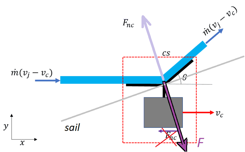

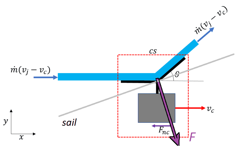

In an attempt to find out when exactly opinions diverge:
Lets say the cart below is moving at a constant velocity ##v_c## with application of ##F_{nc}##. With respect to an inertial frame fixed to the ground the jet has velocity ##v_j##
Assumptions:
Constant flow properties across the jet
Steady Flow
Inviscid Flow
The diagram is indicating the rate of momentum entering\exiting the cart w.r.t the inertial frame per the assumptions.
What is the force ##F_{nc}## acting on the cart?
  • #187
erobz said:
Why do you again propose a scenario where the vehicle moves parallel to the wind? It doesn't work like this. Ýou have the correct setup in the two posts just above.
  • #188
I assume that you mean vc is a vector that can be pointed in any direction, not only along x axis, right?
  • #189
No, this exact set up. What is ##F_{nc}##. This a plant a flag in the ground problem to find out where our opinions diverge. It sets up the base model from which analysis can be gradually expanded.
  • #190
If the boat speed direction is collinear with the true wind, that is not possible for boat to exceed the wind speed.
  • #191
Ok, so what is the force acting on the cart?
  • #192
As I see on your picture, you are at the boat inertial frame, the incoming and outcoming flow has the same speed (vj-vc). I have illustrated the result force direction and sail on your picture.
  • #193
Assumptions:
Steady Flow
You cannot assume that outflow speed equals inflow speed (##v_j - v_c##) in the ground frame, if the vehicle is moving at constant speed against the force ##F_{nc}##. To maintain constant speed the air must be doing work on the vehicle, so it must loose kinetic energy (slow down). Only in the rest frame of the vehicle you can assume (in the ideal case) that inflow/outflow speeds are equal, because no work is done on the static vehicle there.
Once you corrected that: ##F_{nc}## is the rate of horizontal momentum change of the air.
  • #194
What is the magnitude of the force labled ##F_{nc}## in the diagram?
  • #195
Yea I most certainly can. The control volume is not accelerating in this example.
A frame fixed to the ground has to give me the same force as a frame fixed to the cart in this example.

Acceleration is not relevant to work done. If the air exerts a horizontal force on the moving vehicle, then it is doing work on it, and thus must loose energy.

A frame fixed to the ground must give me the same force as a frame fixed to the cart for this example. The cart is not accelerating.

Yes, but the inflow/outflow speeds are different across frames. And outflow speed cannot be equal to inflow speed in the ground frame.
Doesn't matter, The braking force ##F_{nc}## could be used to drive a generator and charge a battery. Where is that energy comming from, if the air doesn't slow down?
  • #199

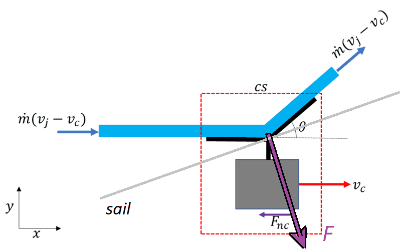

I have change the resistance force on your drawing in accordance with your statement.
Now the boat is not accelerating. The picture is at the boat reference frame.
And I am confused with (##v_j##) and (##v_c##) - is it vectors? Probably not, because you use the same in outgoing flow, but outgoing flow has a different direction. It is scalar values?
  • #200
A.T. said:
Yes, but the inflow/outflow speeds are different across frames. And outflow speed cannot be equal to inflow speed in the ground frame.Doesn't matter, The braking force ##F_{nc}## could be used to drive a generator and charge a battery. Where is that energy comming from, if the air doesn't slow down?
I see your point. However, if the frame is fixed to the cart what I have diagrammed is accurate.
  • #201
Yeah, scalars. I don't know why you are crossing out ##F_{nc}##? That is the force I am asking you to find. It is the force being applied to the cart as to resist acceleration.
  • #202
I think the magnitude of ##F_{nc}## should be opposite to the drag force, which components are (according to your drawing):
##F_x = \dot m(v_j-v_c)+\dot m(v_j-v_c)cos(\theta )##
##F_y = \dot m(v_j-v_c)sin(\theta )##
  • #203
Because the flow is going sideway, that mean the drag force has x and y components, as mention at formulas above. To keep boat at the constant speed, the balancing reaction force should be opposite to the drag force.

If the frame you use is fixed to the cart, then you can assume (as an idealized case) outflow speed = inflow speed.
There is no shear on the vane. This is under the assumption of inviscid flow. ##F_{nc}## is not a drag force from flow over the vane, its a force being applied by something external.
##F_x## is the momentum outflow - momentum inflow. I think you have some signs flipped
$$F_x = \dot m ( v_j -v_c ) \cos \theta - \dot m ( v_j -v_c )$$
##F_{nc}## is as you say the opposite ##F_{nc} = -F_x##

There are no shear forces from the flow over the vane. The flow is assumed inviscid. The drag force ( if the flow wasn't inviscid) from the flow over the vane would be opposite of ##F_{nc}##, with a component in the vertical direction as well. ##F_{nc}## is not a drag force in the traditional sense. It is a force I am applying to the cart.

That is what I assume with the formulas I wrote. I confess that I am not accurate with the sign. But x and y components are in accordance with picture you made.

The blue arrows aren't forces. That’s partially my fault. I have hybridized what is traditionally two separate diagrams ( momentum diagram, and force diagram) for brevity without stating that.
