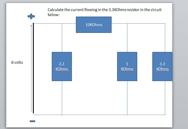

I'm just stuck on a question that I've been given as a quick test, it's really stumped me. I was wondering if anyone could assist me.
Here's the question:
Thank you.

First step, draw in some current paths so you can see where the current is flowing.
You can solve this via mesh analysis: write the currents I1,I2,I3 as loops passing around each of the three independent loops, the write the three mesh equations, taking proper care of the directions which you assigned (I used clockwise for all three) when summing the currents from shared resistors.
6V = 2.2k(I1-I2)
0 = 2.2k(I2-I1) + 10k(I2) + 1k(I2-I3)
0 = 1k(I3-I2) + 3.3k(I3)
Then solve the three simultaneous linear equations via your favorite method (substitution, elimination, Cramer's rule), and I3 is your answer.

I agree that the parallel combination of 3.3k and 1k is ~0.8k (I get 0.77k). But this doesn't help you to get the current through the 3.3k resistor!
Also you cannot sum the resistors around the middle loop ... this is only valid for resistors in series; resistors in series appear 1-2-3 along the same piece of conductor without any additional branches. In this case you have an additional branch which has the 6V voltage source.
It is possible to continue the reduction of the resistor network into a single loop with the voltage source plus one resistor in series. This would provide the total current being supplied by the battery, but now you have lost track of the 3.3k resistor!
The easiest way is to apply the Kirchoff voltage law (KVL) around each loop, or the Kirchoff current law (KCL) at each node, or apply a method (like the mesh method) which is derived from those laws.

Yes, you solve for the total current by reducing the resistor network to an equivalent single resistor. You have already started on this by combining the two resistors that were in parallel.
If you now redraw the circuit with the reduction (using the 0.8 kOhm resistor) you should see that there is now a series combination of two resistors which can be combined; do this, and redraw the circuit.
This time you should see two resistors in parallel with the battery. You can combine the two resistors and use Ohm's law to find the total current.
Do that, keeping all of the circuit diagrams ... then you can start solving backwards, but first things first!

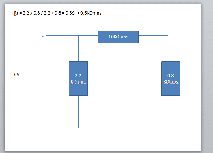

So firstly I do this:

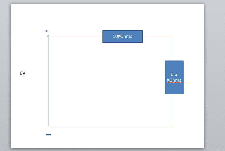

then it turns into this:
Right? Then what shall I do, this is the bit where I get confused on what to do with the two resistors.

The 10k and 0.8k resistors are in series; the 2.2k is NOT in parallel with the 0.8k resistor because there is something on the upper bus between them: the 10k resistor.
So combine the 10k with the 0.8k in series: 10.8k, and then you are left with two resistors in parallel, the 2.2k and the 10.8k. Combine them and then solve for the total current.

You have two resistors in parallel on this diagram ... the next to last circuit ... one is 2.2k, the other is 10.8k.
They both see the same voltage: 6 volts. So you can calculate the current through each of these two paths via Ohm's law. You need to do this so that you know the current going through the 10.8k equivalent resistor.
You will use that current for the next step.
I get 1.98k (2k) for the total equivalent resistance, which means that the total current is
I=6v/2k Ohms=3 mAmps. You should always keep track of your units.
Correction: I get 1.83 kOhms for the equivalent resistance, and 3.3 mAmps for the total current - so your total current is correct.
