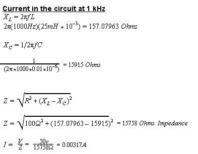

So am trying to find the current in the RLC series circuit ,but i think i have done something wrong ,if anyone could tell me where i went wrong ,it would be great ,thank you
Resistor-100ohms
Capacitor-0.01uF
Inductor-25mH
Voltage Source-50v a.c
1kHz
I checked your work and can't spot any mistake. Maybe the mistake is in the given data, are you sure the capacitor value is 0.01uF? Cause that is what makes the impendance big.

o sorry ,i just wasn't 100% sure that it was correct ,just wanted to make sure i have done everything right , thank you
