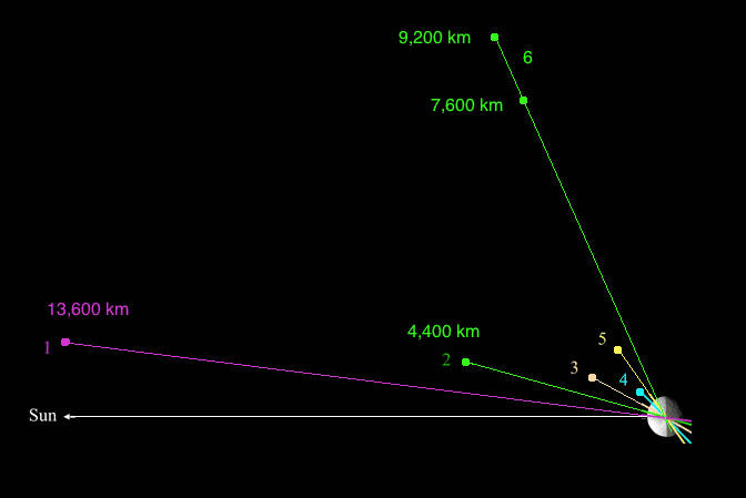

  • #704
You're right, on several counts :oldbiggrin: That was the descent from initial "RC3" orbit to "survey" orbit.
Code:
Orbit    dates      altitude(km)  pixelsize(m) res/HST  period  soccerball at
RC3    April 23–May 9    (13,600)    (1,300)    24     15 days    (3.0 meters)
Survey    June 6-30      (4,400)      (410)     73     3.1 days    (1.0 meters)
HAMO    Aug 17–Oct 23    (1,470)      (140)     217    19 hours    (33 cm)
LAMO Dec 15–end of mission (375)      (35)      850    5.5 hours    (8.5 cm)
Also IIRC the descent from survey to HAMO was a lot more elliptical than the present trip from HAMO to LAMO. The current trajectory seems like a fairly trim orderly spiral. At least if we go by Simview (and it has proven reasonably reliable so far.)

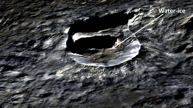

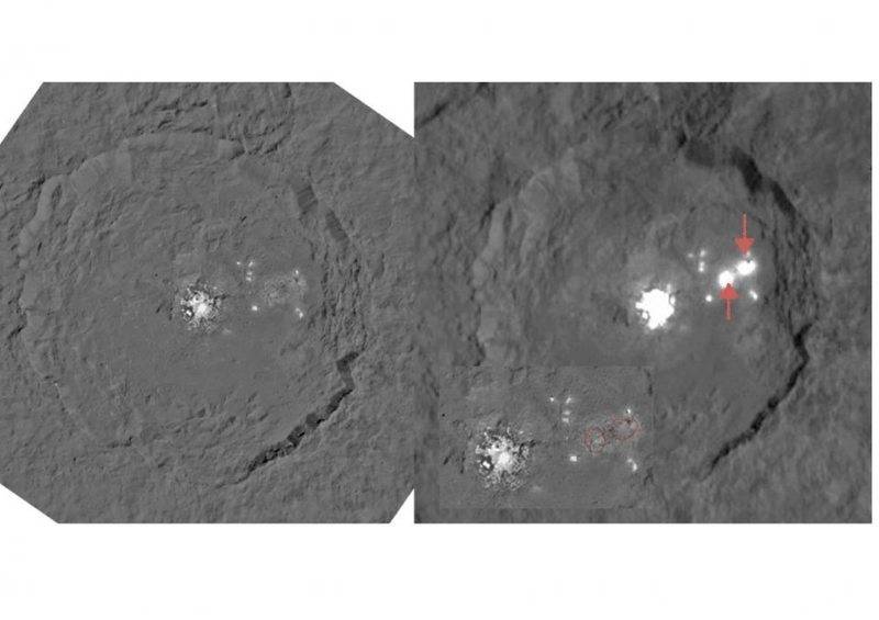

Because of its density (2 g/cc) Ceres is assumed to have a large component which is water, making it similar to a number of outer solar system bodies, but unique in the inner solar system. It's shape indicates some degree of differentiation---with a denser core and a less dense outer layer (mantel) covered by some type of crust. The outer mantel may be a rock+ice mixture---could vary in consistency---a 60%-40% mix was conjectured recently and reported by Lakdawalla. I don't know of a cutaway diagram for Ceres that reflects current thinking. The less oblate the more differentiated, and Ceres is comparatively UN-oblate.
The next image is a reminder of the analysis of surface chemistry (down to depth of one meter) that is planned for the final stage, starting in a little over 2 weeks. This involves neutron and gamma ray spectroscopy.
Optical and IR spectroscopy have already indicated some stuff about the surface material, reported at a recent conference (Lakdawalla's account). Ammonia-bearing clays.
This is basically how Dawn will be able to identify and estimate abundances of various chemical elements in the surface material (to a depth of about 1 meter). Neutron and gamma spectroscopy under bombardment by cosmic rays.
