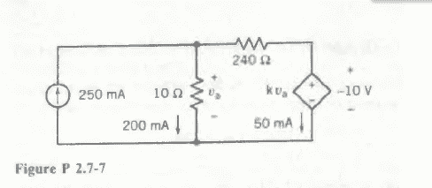

So the goal in this case is to find k, the gain of the dependent source shown as a diamond.
Formula for dependent voltage sources:
V=g*V0
In this case
V=k*Va
I would get a negative value for k, because k=V/Va=-10V/(0.2A*10Ω)=-5
But can you have a negative value for k? Is that possible? Or did I get the signs wrong?
Thanks in advance.
Sure you can have negative gain.
Vo= -K * Vin
implies an inverting amplifier with gain = K
If K = 5 and Vin= 2 then Vo = -10
