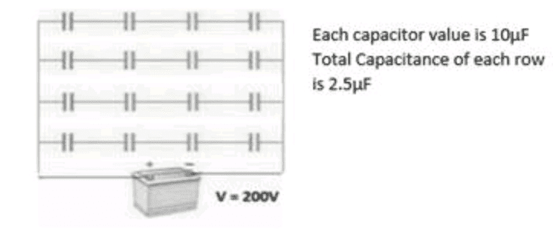

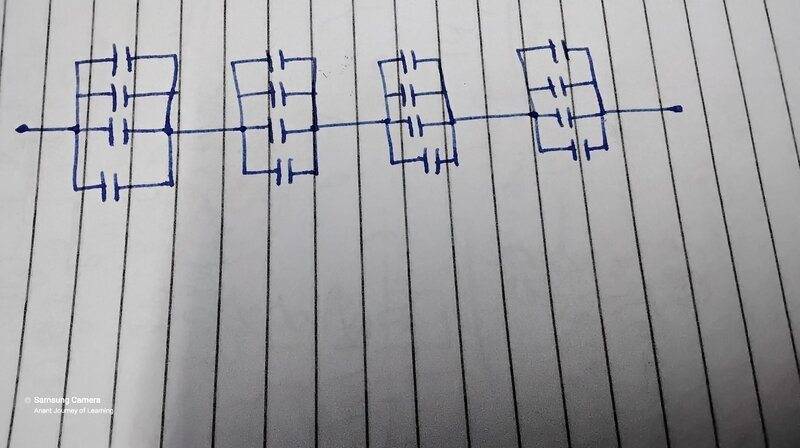

It is required to construct a 10mF capacitor which can be connected to a 200V Battery. Capacitors of Capacitance 10mF are available but they can withstand only 50V. Design a combination which can yield the desired result.
C=Q/V
My attempt was this:
The textbook answer was:
Is my approach wrong?
Both approaches are valid.
If one wanted to choose between those two approaches (or other possible approaches), then it would be interesting to consider the effect of a failure (fail open or fail closed) of one of the components.
On failure of components, the textbook answer would be preferred,right?
Not necessarily. It depends on what failure type is most prevalent.
A series array of capacitors in parallel will not change its capacitance much if one element fails open.
A parallel array of capacitors in series will not change its capacitance much if one element fails closed.
But then one should also be concerned with the possibility of cascading failure. I do not build such things for a living, so I cannot offer an opinion on which approach is "best" in real life.
Edit: a quick trip to Google says that ceramic capacitors tend to fail closed (short circuit) on overload.
Cascading failure yields a short circuit either way.
