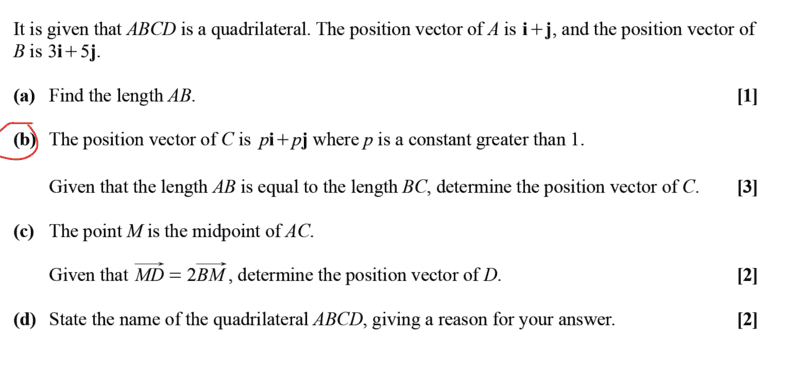

Kindly see attached.
Vectors
Highlighted part only...
Part (a) was easy ##2\sqrt 5##.
For part (b),
...##BC=4i+2j##
it follows that,
##OC=OB+BC##
##OC=3i+5j+4i+2j=7i+7j## correct? any other better approach guys!
For part (c),
I will form the equations as follows;
Let ##D(x,y)## then,
##x-4=2(4-3)##
and
##y-4=2(4-5)## where M=##(4,4)##
##x=6, y=2##,
part (d) - Kite.
For (b). you have simply asserted that BC = 4\mathrm{i} + 2\mathrm{j}. This is correct, but you need to justify it by solving <br /> 20 = |AB|^2 = |BC|^2 = (p - 3)^2 + (p - 5)^2.
