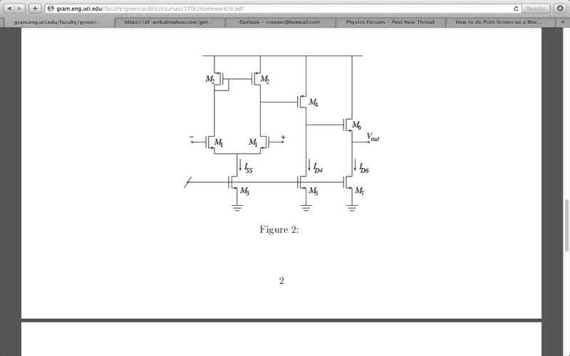

Find the differential gain int terms of small signal parameters of the attached image.
I don't think we need any equations. Just some basic mosfet knowledge.
Not going to draw the small signal circuit, because it would take a long time.
My attempt at the question is attached along with the schematic. When comparing my answer to
the answer in the solutions, I am missing a factor of (1+gm(ro6 || ro7))^-1
Where || means "in parallel." I am really close but it looks like I am missing a critical part. Thank you for your help.

My friend was kind enough to point out my problem. Turns out the third stage's (class A output stage) output resistance is not ro7 || ro6, this is due to the fact tha Vgs of M6 is not zero, so the dependent current source in the small signal hybrid pi model conducts current, hence I needed to take that into account when calculating output resistance. That is where the extra factor comes in.
Thank you.
