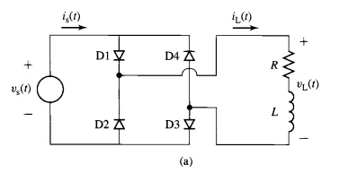

Calculation of the inductor current in full bridge circuit
Impedance, X = R + jwL

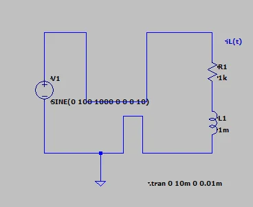

The above is the circuit i am calculating the inductor current.
During the positive half of the sine input D1 and D3 are conducting so the circuit becomes

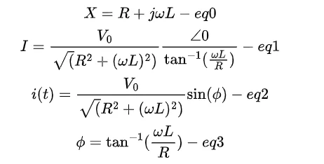

My calculations are as below
Are the above equations ok? When transitioning from +Ve cycle to -Ve sine wave does the above equations still applicable? During the negative cycle the diodes D2 and D4 are conducting and the current direction is going into the inductor same as when diodes D1 and D3 are conducting. According to me the same equations can be used, but few doubts are when does the time constant L/R comes into picture and is it part of the above equation or it has to be treated separately and solved? And also the inductor current cannot change immediately where does that happen?
The first approximation is that the diodes have zero forward voltage, that inductor current is limited by the resistance, and that the average voltage across the inductor will be zero.

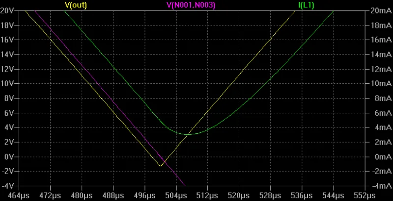

After the zero crossing of the applied voltage waveform (magenta), the diodes continue to conduct, the inductor current (green) therefore never falls to zero. Note that all diodes are conducting during the partial microsecond of transition. Also, Vout, (yellow), applied to the R+L load, goes negative by two forward junction voltages during the transition.
In general, at all times for the FW bridge; Vout = |V1| - 2·Vpn
That does change the spectrum of the rectified voltage only very slightly.

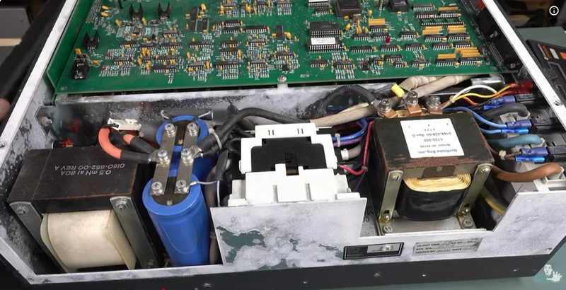

Also, EVERY time you use these you'll have a shunt capacitor to make a LC 2nd order LPF, which the OP circuit doesn't have. It looks more like a HW problem than a real PS; IDK maybe a solenoid drive or such?
On the left front in this picture you can see the LC input filter for a 15KW linear PS. That choke is heavy!
