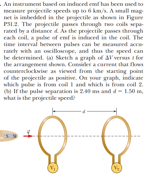

For this problem,
The solution is,

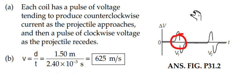

However, dose anybody please know why the graphs for ##V_1## and ##V_2## are discontinuous where they cross the time axis?

It only looks like a drawing issue, not something to do with the physics. The voltage induced is just proportional to the change in the B-field through the loops, which is certainly continous in the real world. Is this confusion affecting your ability to solve your homework problem, or just a curiousity at this point?
If (b), I would recommend that you just ask a TA or the professor informally when you next see them.
Likes member 731016

Thanks for your help @berkeman ! Just (b) at this point, but it does sound like it drawing issue as you mention.
