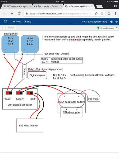

Hello, I've been building my own solar panel system and throughout this process I've accumulated a lot of questions. If anyone could help answer them I would greatly appreciate it!
First I'll start off explaining what I have.
A polycrystalline solar panel 17V 2.2A and a mono crystalline panel 4.8V 4A (read by multimeter) I connect them in parallel to produce 16.8V 6.2A. Each of them have a "6A axial type" diode connecting the positive line and the solar cells.(I read that you use them to stop power from returning into the solar panels)
I've connected them to a Shunt (which reads 12.9V 1.96A coming from the solar panels) and charge controller using a little less than 50 Ft of 10 gauge stranded copper wires. The charge controller is connected to a 12V 35ah battery that's connected in parallel to a 12V 7ah battery. I have an inverter that I connect to the load of the charge controller. I use that to power lights or charge cell phones. So that's my basic setup. As for my questions, I apologize if they seem a bit random and the large amount of questions I have.
-Why is the shunt displaying 12.9V 1.96A if my multimeter is reading 16.8V 6.2A?
-I bought 10 monocrystalline solar cells (4.8w) and connected them using adhesive copper tape but they produce less than my (2.8w) mono solar panel I built. I had soldered the solar panels up until I discovered copper tape. So does copper tape hold less lots and amps?
-When I tried to connect my 4.8 W monocrystalline solar panel to my regular setup in parallel, it seemed like it actually took away from the power everything was producing, I don't know why.
-Are these diodes actually needed if I have a charge controller?
-Are they just taking away from the power the solar panels produce?
-I decided I wanted to try powering small devices somehow and I found DC to DC converters. But I have no idea how to control the volts and amps enough so that it won't damage the electronics. I'm trying to power things like a peltier and a small fan. Can anyone help me understand how I can use the power I get to power these electronics?
That's all I'll ask for now... it would be easier if I could upload pictures from my iPad or phone but I couldn't figure out how. I apologize in advance for any information I am missing and thank you for reading all of it.

The schematic really is needed before we go much further. What you have posted above makes no sense (unless I missed a place where you corrected it).
Likes Averagesupernova
I finished making the schematic and I apologize for how crude it is, its my first time ever making one. If there is any information I left out again I apologize.
I'm apparently terrible with computers too... but I'm trying to learn how to work with them.
So if I wanted to fix the problem of connecting a 17V and a 4.8V panel, would the solution be to connect DC to DC Converters?
I've looked on amazon and it seems like the problem is those converters can step up the voltage into the 30s but the amperage it can handle is too low (near 2-3 amps). The ones that look like they can handle the power my solar panels are producing are like $30. Also I've never bought a transformer or converter before.
Thanks for the drawing.
No need to apologize -- you are learning by doing, and working with solar energy systems, which is all great. :smile:
This has probably already been mentioned in the thread, but keep these things in mind:
  • Stiff voltage sources like batteries need to be rated at the same output voltage before you can hook them in parallel
  • PV panels are medium-stiff voltage sources, so you need to only connect them in parallel if they have the same output voltage rating at the same input insolation
  • You can parallel-connect different PV panels of the same output voltage even if they are rated at different output currents at that output voltage for the same insolation
  • You can series connect PV panels that are rated at different output voltages but the same output currents given the same insolation
  • There is typically a Maximum Power Point (MPP) for a PV panel output, where it is producing the most output power for a given insolation. Good PV power converters will help the PV to work at that MPP (a tradeoff between the PV panel's output voltage and current).
  • Differently built and rated PV panels may have different MPPs, so it's generally a bad idea to mix and match if you want to build an optimum system
Hope that helps.

@Brandon91man Move your shunt around. Place it in series with each PV panel individually and you will see why paralleling your two particular panels is not doing what you think it is.
Likes Brandon91man and Asymptotic

There really is only one way to hook a shunt. It goes in series with the current you are trying measure. Don't hook it across a voltage source.

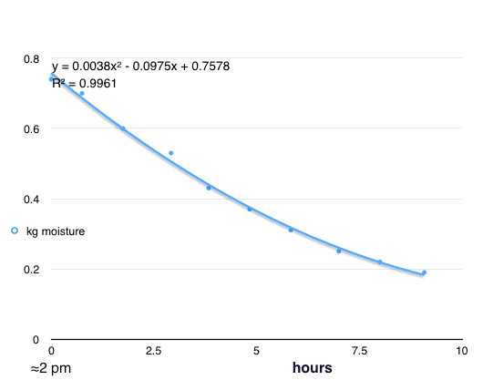

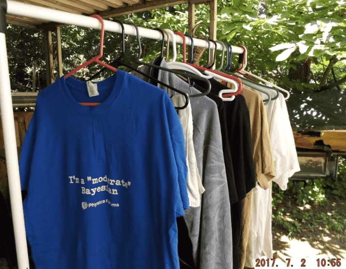

Just finished up some washer and dryer experiments this morning.
My wash machine consumes 250 watt hours of energy over the course of 40 minutes, with a maximum output of around 900 watts. (Not counting surge current).
My solar powered clothes dryer consumed only my time. Which non-retirees will tell you is a waste of time and money. Unless they are poor, and then they are probably already ahead of you and me.
Obligatory sciencey graph:
So I have moved the shunt to each solar panel individually. What I found is that the shunt powers on with the poly panel but not the mono panel. When I measure the panels with my multimeter, the values come back pretty close to what I've measured before: (mono = 5V 5A) (poly = 16V 2A). When I read the display from the shunt, it shows anywhere between 25 - 32 volts and 0.5 - 2 amps. These numbers bounce back and fourth between these values a lot. The batteries I'm charging show a steady 13.1.
Does it do this because the power cannot be pushed into the battery and that makes Voltage go up while current goes down?
Or do I have a faulty shunt?
Also there is no shade or anything blocking sunlight to make this happen.
How can you have a 5A reading from a multimeter when the shunt told you the opposite?
Concerning the 25-32 volt reading with current draw of .5 to 2 amps, I will assume that the higher the current the lower the voltage assuming you always have the same amount of sunlight on the panel? A solar cell is not a perfect voltage source so as you draw more current from it, the voltage on the output terminals will fall. Do the same thing with a couple of AA dry cells and resistors to vary the load around. You will find the same thing happens. The more current you draw, the lower the voltage will fall.
Likes Brandon91man
